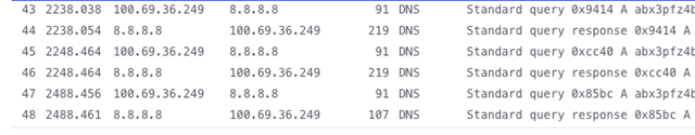

Issue 1: DNS Resolution for the AWS IoT Broker
DNS resolution for the broker fails unless we force a static IP.

zsock_getaddrinfo() returns -3, which is strange because the same function works fine for resolving the NTP server.
Even more confusing: on the SIM card portal, we can see the DNS query for the AWS broker happening correctly — yet our code still times out.

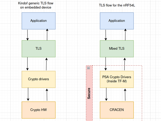

Issue 2: Handling Certificates in Production
What is the recommended way to manage certificates securely on the nRF54L15?
We’ve looked at the TF-M examples, but we’re still unsure how this should work in a real production workflow.
Key questions:
  • How should certificates be provisioned on a production device?
  • Can they be embedded in the firmware image and then stored securely by TF-M at runtime?
  • Should they be erased from normal flash afterwards?
  • What’s the typical workflow for securely flashing these assets when manufacturing devices?
Any insight from someone who has already implemented this would be extremely helpful.

    DNS issue:
    I've enabled debug on net_sockets and on net_dns and this is what I see when I call the zsock_getaddrinfo() inside a thread with priority 5:
    [00:00:54.417,900] <dbg> net_sock_addr: exec_query: (): Timeout 5000
    [00:00:54.418,135] <dbg> net_dns_resolve: dns_resolve_name_internal: (): DNS id will be 37718
    [00:00:54.418,418] <dbg> net_dns_resolve: dns_write: (): [0] submitting work to server idx 0 for id 37718 hash 43467
    [00:00:54.715,776] <dbg> net_sock: zsock_received_cb: (rx_q[0]): ctx=0x20004788, pkt=0x20027e6c, st=0, user_data=0
    [00:00:54.716,238] <dbg> net_sock_addr: dns_resolve_cb: (net_socket_service): dns status: -100
    [00:00:54.716,484] <dbg> net_sock_addr: dns_resolve_cb: (net_socket_service): dns status: -100
    [00:00:54.716,718] <dbg> net_sock_addr: dns_resolve_cb: (net_socket_service): dns status: -100
    [00:00:54.716,950] <dbg> net_sock_addr: dns_resolve_cb: (net_socket_service): getaddrinfo entries overflow
    [00:00:54.717,195] <dbg> net_sock_addr: dns_resolve_cb: (net_socket_service): dns status: -100
    [00:00:54.717,427] <dbg> net_sock_addr: dns_resolve_cb: (net_socket_service): getaddrinfo entries overflow
    [00:00:54.717,668] <dbg> net_sock_addr: dns_resolve_cb: (net_socket_service): dns status: -100
    [00:00:54.717,897] <dbg> net_sock_addr: dns_resolve_cb: (net_socket_service): getaddrinfo entries overflow
    [00:00:54.718,138] <dbg> net_sock_addr: dns_resolve_cb: (net_socket_service): dns status: -100
    [00:00:54.718,365] <dbg> net_sock_addr: dns_resolve_cb: (net_socket_service): getaddrinfo entries overflow
    [00:00:54.723,595] <dbg> net_sock_addr: dns_resolve_cb: (net_socket_service): dns status: -100
    [00:00:54.723,827] <dbg> net_sock_addr: dns_resolve_cb: (net_socket_service): getaddrinfo entries overflow
    [00:00:54.724,072] <dbg> net_sock_addr: dns_resolve_cb: (net_socket_service): dns status: -100
    [00:00:54.724,303] <dbg> net_sock_addr: dns_resolve_cb: (net_socket_service): getaddrinfo entries overflow
    [00:00:54.724,547] <dbg> net_sock_addr: dns_resolve_cb: (net_socket_service): dns status: -103
    Normal DNS_EAI_INPROGRESS and DNS_EAI_ALLDONE status.
    When zsock_getaddrinfo() is called from sysworkq priority -1 I guess:
    [00:00:54.089,481] <dbg> net_sock_addr: exec_query: (sysworkq): Timeout 5000
    [00:00:54.089,726] <dbg> net_dns_resolve: dns_resolve_name_internal: (sysworkq): DNS id will be 34236
    [00:00:54.090,020] <dbg> net_dns_resolve: dns_write: (sysworkq): [0] submitting work to server idx 0 for id 34236 hash 43467
    [00:00:59.190,527] <dbg> net_dns_resolve: dns_resolve_cancel_with_hash: (sysworkq): Cancelling DNS req 34236 (name <unknown> type 1 hash 0)
    [00:00:59.190,845] <dbg> net_sock_addr: dns_resolve_cb: (sysworkq): dns status: -101
    [00:00:59.191,067] <err> mqtt_helper: getaddrinfo() failed, error -3
    [00:00:59.191,257] <dbg> mqtt_helper: mqtt_state_set: Skipping transition to the same state (MQTT_STATE_DISCONNECTED)
    [00:00:59.191,506] <err> aws_iot: mqtt_helper_connect, error: 3
    [00:00:59.191,675] <err> connection: aws_iot_connect, error: 3
    [00:00:59.430,549] <dbg> net_sock: zsock_received_cb: (rx_q[0]): ctx=0x20004788, pkt=0x20027e90, st=0, user_data=0
    No dns status logs, and after the 5 seconds timeout I get the DNS_EAI_CANCELED which comes from timeout implementation. On the sim card portal I see the DNS requests.
    So, is this somehow related to priorities? Is the sysworkq preempting the modem handler functions, like cmux?

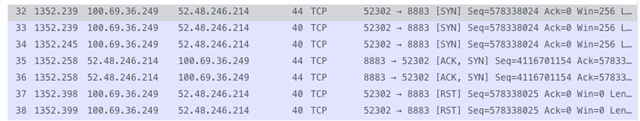

    Connection issue:
    For the connection to the MQTT itself it might be a similar issue? Forcing the IP I still get -116  ETIMEDOUT, but on the SIM card portal I see the SYN attempts and re.transmissions and the reply.
    [00:00:54.184,142] <dbg> mqtt_helper: broker_init: Using static IP address: 52.48.246.214
    [00:00:54.184,408] <dbg> mqtt_helper: broker_init: IPv4 Address found 52.48.246.214 (AF_INET)
    [00:00:54.184,647] <dbg> mqtt_helper: client_connect: Using build-time provided security tag value from Kconfig
    [00:00:54.184,893] <dbg> mqtt_helper: mqtt_state_set: State transition: MQTT_STATE_DISCONNECTED --> MQTT_STATE_TRANSPORT_CONNECTING
    [00:00:54.185,255] <dbg> net_sock_tls: tls_alloc: (sysworkq): Allocated TLS context, 0x20003fd0
    [00:00:54.185,651] <dbg> net_tcp: tcp_conn_ref: (sysworkq): conn: 0x20028004, ref_count: 1
    [00:00:54.185,883] <dbg> net_tcp: tcp_conn_alloc: (sysworkq): conn: 0x20028004
    [00:00:54.186,104] <dbg> net_sock: zsock_socket_internal: (sysworkq): socket: ctx=0x20004830, fd=6
    [00:00:54.186,385] <dbg> net_tcp: net_tcp_recv: (sysworkq): context: 0x20004830, cb: 0x23fc9, user_data: 0
    [00:00:54.191,698] <dbg> net_ctx: net_context_bind: (sysworkq): Context 0x20004830 binding to TCP 0.0.0.0:52302 iface 1 (0x20002da8)
    [00:00:54.192,040] <dbg> net_tcp: net_tcp_connect: (sysworkq): context: 0x20004830, local: 0.0.0.0, remote: 52.48.246.214
    [00:00:54.192,468] <dbg> net_tcp: net_tcp_connect: (sysworkq): conn: 0x20028004 src: 100.69.36.249, dst: 52.48.246.214
    [00:00:54.192,888] <dbg> net_tcp: tcp_start_handshake: (sysworkq): LISTEN->SYN_SENT
    [00:00:54.193,114] <dbg> net_tcp: tcp_conn_ref: (sysworkq): conn: 0x20028004, ref_count: 2
    [00:00:55.256,951] <dbg> net_tcp: tcp_resend_data: (tcp_work): send_data_retries=0
    [00:00:56.853,335] <dbg> net_tcp: tcp_resend_data: (tcp_work): send_data_retries=1
    [00:00:57.193,401] <dbg> net_tcp: tcp_conn_close_debug: (sysworkq): conn: 0x20028004 closed by TCP stack (net_tcp_connect():3857)
    [00:00:57.193,709] <dbg> net_tcp: tcp_conn_close_debug: (sysworkq): SYN_SENT->CLOSED
    [00:00:57.193,934] <dbg> net_sock: zsock_received_cb: (sysworkq): ctx=0x20004830, pkt=0, st=-116, user_data=0
    [00:00:57.194,206] <dbg> net_sock: zsock_received_cb: (sysworkq): Marked socket 0x20004830 as peer-closed
    [00:00:57.194,459] <dbg> net_tcp: tcp_conn_unref: (sysworkq): conn: 0x20028004, ref_count=2
    [00:00:57.194,687] <dbg> net_tcp: net_tcp_connect: (sysworkq): conn: 0x20028004, ret=-116
    [00:00:57.195,008] <dbg> net_sock: zsock_close_ctx: (sysworkq): close: ctx=0x20004830, fd=6
    [00:00:57.195,246] <dbg> net_tcp: net_tcp_recv: (sysworkq): context: 0x20004830, cb: 0, user_data: 0
    [00:00:57.195,547] <dbg> net_tcp: net_tcp_put: (sysworkq):  [CLOSED Seq=578338025 Ack=0]
    [00:00:57.195,765] <dbg> net_tcp: net_tcp_put: (sysworkq): context 0x20004830 CONNECTING
    [00:00:57.195,989] <dbg> net_tcp: tcp_conn_unref: (sysworkq): conn: 0x20028004, ref_count=1
    [00:00:57.201,213] <err> mqtt_helper: mqtt_connect, error: -116
    [00:00:57.201,400] <dbg> mqtt_helper: mqtt_state_set: State transition: MQTT_STATE_TRANSPORT_CONNECTING --> MQTT_STATE_DISCONNECTED
    [00:00:57.201,680] <err> aws_iot: mqtt_helper_connect, error: -116
    [00:00:57.201,861] <err> connection: aws_iot_connect, error: -116
    [00:00:57.202,079] <dbg> net_ctx: net_context_unref: (tcp_work): Context 0x20004830 released
    [00:00:57.389,007] <dbg> net_tcp: net_tcp_reply_rst: (rx_q[0]): RST Seq=578338025 Len=0
    [00:00:57.389,477] <dbg> net_tcp: net_tcp_reply_rst: (rx_q[0]): RST Seq=578338025 Len=0

    Fernando Fontes said:
    I want to protect certs from being read essentially, to avoid impersonating of the machine.
    Good and clear answer!
    So as I said below:
    "As you can see, Mbed TLS runs in NSPE, meaning that the certificates has to be in NSPE when you run TLS, no matter what. "
    That said, you can still store the certs in SPE during rest.
    Looking a bit around to explain this I remembered that we do have provisioning support for credentials for our Wi-Fi solution. And that is "cert handling in the nRF application", which is essentially the same as you do.
    So I recommend that you have a look at how we do it in the SoftAP Wi-Fi provision sample and the SoftAP Wi-Fi provision library, as well as the docs on Wi-Fi Management.
    Does this explain what you need?

  • I want to protect certs from being read essentially, to avoid impersonating of the machine.
    This does not make sense. A certificate does not contain any secret credentials; just identity information, public keys and signatures etc. Note that certificates are also typically sent in plaintext over the air (at least with TLS 1.2). What would make sense to store in a secure storage is the private key matching a certificate's public key, which is only useful in case you want that the server should authenticate the client (assuming nRF54 is the TLS client).
    Thaks for the clarification Emil!
