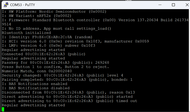

  • Erasing the board makes no difference.
    I have also confirmed that there is no pair information using bluetoothctrl on a Linux machine.
    To check that the DK buttons are not malfunctioning, I set it to output a log when num_comp_reply() is called, but there is no sign of a malfunction.
    Setting up the sniffer takes some time, so I tested it using Bluetooth Standalone.
    Also, my setup is a standard development kit and sample code, except for the Linux host machine.
    The Linux machine (T14s gen2, Ubuntu 24.04) is also a very standard environment.
    Would it be possible for Nordic to test it?

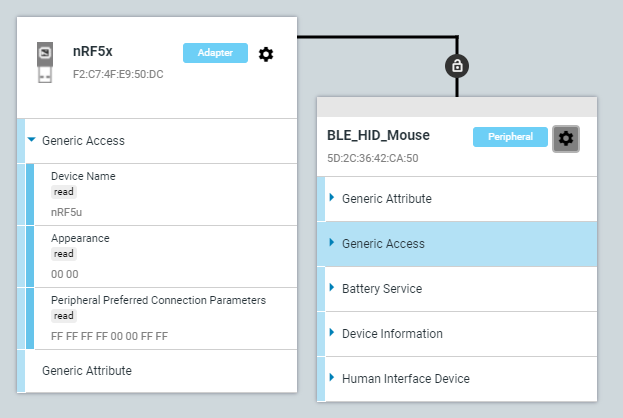

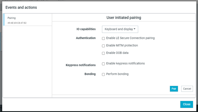

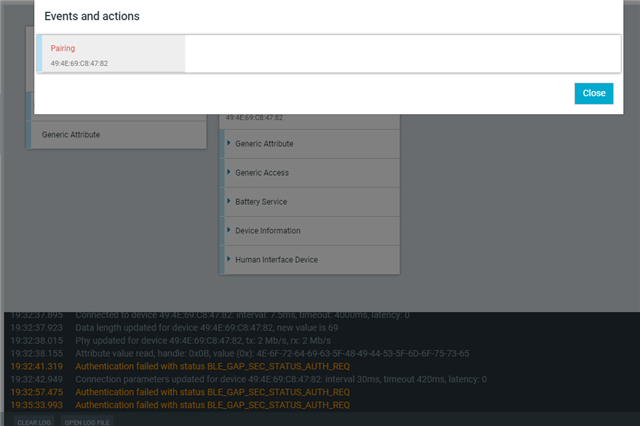

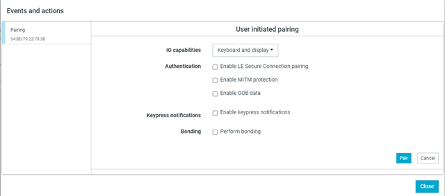

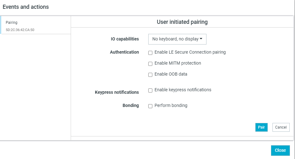

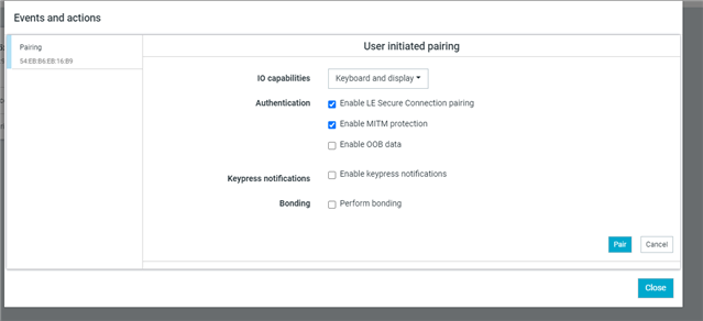

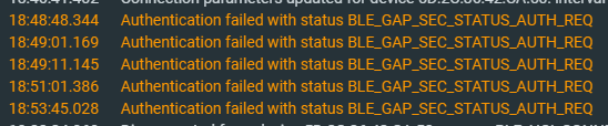

  • Does the log from the nRF say the same when you attempted using nRF Connect for Desktop -> Bluetooth Low Energy?
    I noticed that you are using "No keyboard, no display" in nRF Connect for Desktop -> Bluetooth Low Energy.
    Can you please try to use "Keyboarrd And Display"?
    Does that change anything?
    A sniffer trace could still be helpful.
    Edvin
  • Sorry, I left it set to test mode for another device (the device I'm developing on).
    However, even when I changed it to "Keyboard And Display", the result was the same.
    Note: The target board has been changed to the nRF52833DK due to a lack of board.
    Analysis using a BLE sniffer seems a bit time-consuming. I'll check it tomorrow.
