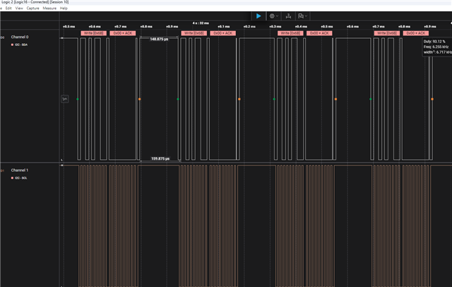

Issue 1:
disabling the interrupts does not seem to work
	// Clear all events before enabling interrupts, just in case other interrupt source was configured before.
	for (uint32_t i = 0; i < NPMX_EVENT_GROUP_COUNT; i++) {
	        npmx_err = npmx_core_event_interrupt_disable(&npm1300_instance, (npmx_event_group_t)i, NPMX_EVENT_GROUP_ALL_EVENTS_MASK);
	        if(npmx_err == NPMX_SUCCESS)
	        		printf("Event Cleared\n");
	        		osDelay(100);
the above code comes from the PORTING Guide.
when i run that block it looks like it never reaches the NPMX_SUCCESS
I have attached the I2C transactions
it looks like it is writing 0x00 and not 0xFF as I would expect.

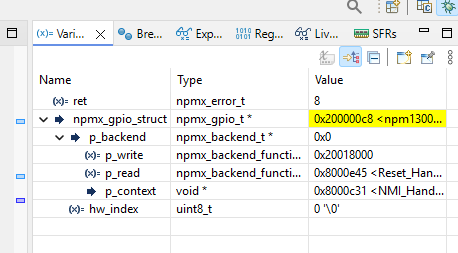

Issue 2:
I am trying to set a GPIO as an Interrupt.
	npmx_error_t ret;
	npmx_gpio_t *npmx_gpio_struct;
	// Set GPIO 3 as GPIO Interrupt.
	npmx_gpio_struct = npmx_gpio_get(&npm1300_instance, 3);
	ret = npmx_gpio_mode_set(&npmx_gpio_struct, NPMX_GPIO_MODE_OUTPUT_IRQ);
when i run this it does not look like I get the Index of 3 and I cannot tell about the pointer to the I2C Instance
then the call to npmx_gpio_mode_set throws a hard Fault.
I have tried it with declaring a separate npmx_gpio_t structure and inline declaration like the porting guide.  They both throw faults.

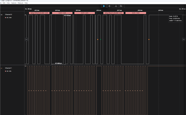

which I guess I should ask if the init function call from the porting guide
static npmx_error_t my_i2c_write_function(void * p_context, uint32_t register_address, uint8_t * p_data, size_t num_of_bytes);
static npmx_error_t my_i2c_read_function(void * p_context, uint32_t register_address, uint8_t * p_data, size_t num_of_bytes);
static void my_npmx_initialization_function(void)
    npm1300_backend.p_read = my_i2c_read_function;
    npm1300_backend.p_write = my_i2c_write_function;
    npm1300_backend.p_context = NULL; // Optional context for our use
    npmx_error_t npmx_err = npmx_core_init(&npm1300_instance, &npm1300_backend, NULL, true);
    // TODO: Verify that npmx_err == NPMX_SUCCESS
should give me a I2C like this
it appears to write 0x05 and 0x09, then read 0x00.
is this expected from the init Function?
I am looking more into it, but any guidance can help
  • I would first of all like to see your `my_i2c_write_function` and `my_i2c_write_function` implementations, are you sure they are implemented properly?
    On the first screenshot nothing is happening really. It's neither a write nor a read transaction. Examples of those you can see in the datasheet https://docs.nordicsemi.com/bundle/ps_npm1300/page/chapters/core_components/ctrl_reg/doc/frontpage.html#d89e68
    On the second screenshot it seems to read out the 0x0509 register (ADC_CONFIG) getting value 0. While this can be part of the initialization function, it shouldn't be the only transaction in this case... Did you check the return code of this function call?
