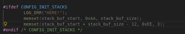

I'm building the nrf/samples/openthread/cli sample with the nrf54l15dk/nrf54l15/cpuapp/ns board. The only change I'm making is enabling CONFIG_DEBUG_THREAD_INFO.
The app runs fine until you pause execution in any way with the debugger. When GDB pauses execution, it reads the call stacks which eventually lead to a dummy return address since GDB doesn't know to stop at z_thread_entry. GDB tries to continue unwinding the call stack and ends up reading the memory at the dummy return address. This triggers the MPC to cause a memory access error. For instance, if CONFIG_INIT_STACKS is enabled, this results in a memory access error at 0xAAAAAAAA since the stack was initialized to that value.
I've verified that this is the cause by purposefully placing a custom canary value in the initial return address. When I do this, I can see that the memory access error always lines up with what I put there. I end up in a TF-M halt.
Additionally, although this is potentially hacky? You can do a similar thing, replacing the return address with the return address for main.
This takes advantage of GDB's built in functionality where it stops unwinding the stack after seeing the main symbol. This "fix" could have other side effects though that make it impractical.
This causes GDB to stop unwinding and prevents the memory access error.
The changes shown here are in zephyr/kernel/thread.c within the CONFIG_INIT_STACKS ifdef.
