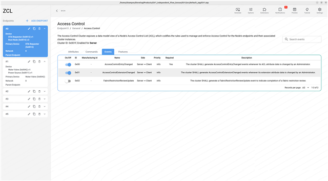

    But regarding the AccessControlEntryChanged always failing, I still don't know the reason.
    Xiongwei.Wang
    Does this happen when you run the test on itself as well?
    I see several AccessControlEntryChanged events in the log, so the response from the DUT does contain the expected AccessControlEntryChanged events. However, the test states that it looks for a list of events containing 1 element:
    * Test step:
    *     3: TH1 reads DUT Endpoint 0 AccessControl cluster AccessControlEntryChanged event	Expected outcome: Result is SUCCESS value is list of AccessControlEntryChangedEvent events containing 1 element
    Your DUT returns multiple events. I do not know exactly how the test script is coded, but if it is implemented to look for exactly one event matching the criteria, then it could be that it fails because there are multiple events matching. If that is the case, you can try a factory reset to clear all previously generated events before re-running the test (on its own, not as part of a batch test).
    Marte

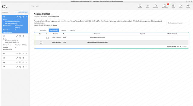

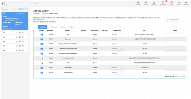

  • Hi, Marte,
    I am using NCS v3.1.1 with the nRF54L15DK. I created a project based on the Matter template and copied the .zap file from my original project. However, I am still encountering the same problem with the AccessControlEntryChanged event in TC-ACL-2.5 and TC-ACL-2.8. I tried to test them one by one, but it didn't work. It seems the ACL test cases might depend on each other.
    I have attached the project here for you to try. If you need more information, such as the TH configuration steps or other files, please let me know. I would be happy to provide them.
    Valve.zip
    Xiongwei.Wang
  • Hi, Marte,
    Valve.zip
    Xiongwei.Wang
