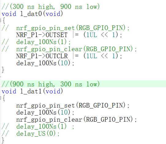

I encountered a very strange problem. This problem originated from my development of RGB color lights using the NRF52840. Due to the limitations of RGB color lights, I needed to control the high and low level changes of the IO port extremely quickly. For example, I needed a high level of 300ns and a low level of 900ns.
When I used the function nrf_gpio_pin_set, I found that it did not conform to this specification. When I chose to directly use NRF_P1->, my RGB worked properly and had been used normally before. However, there was a persistent problem: the current was much higher than expected. I originally suspected that the current of the RGB itself was high, but when I removed the RGB, it was still the same.
At this point, I began to investigate the software problem. When I finally removed NRF_P1->, the cause was found and the current was normal. I was very puzzled by this. I did another test. I reset the software but did not operate the RGB light, that is, I did not use NRF_P1->OUTSET, the current was normal. However, as long as I used NRF_P1->OUTSET, even though the RGB light had been removed by me, there was still an additional 2mA of current.
