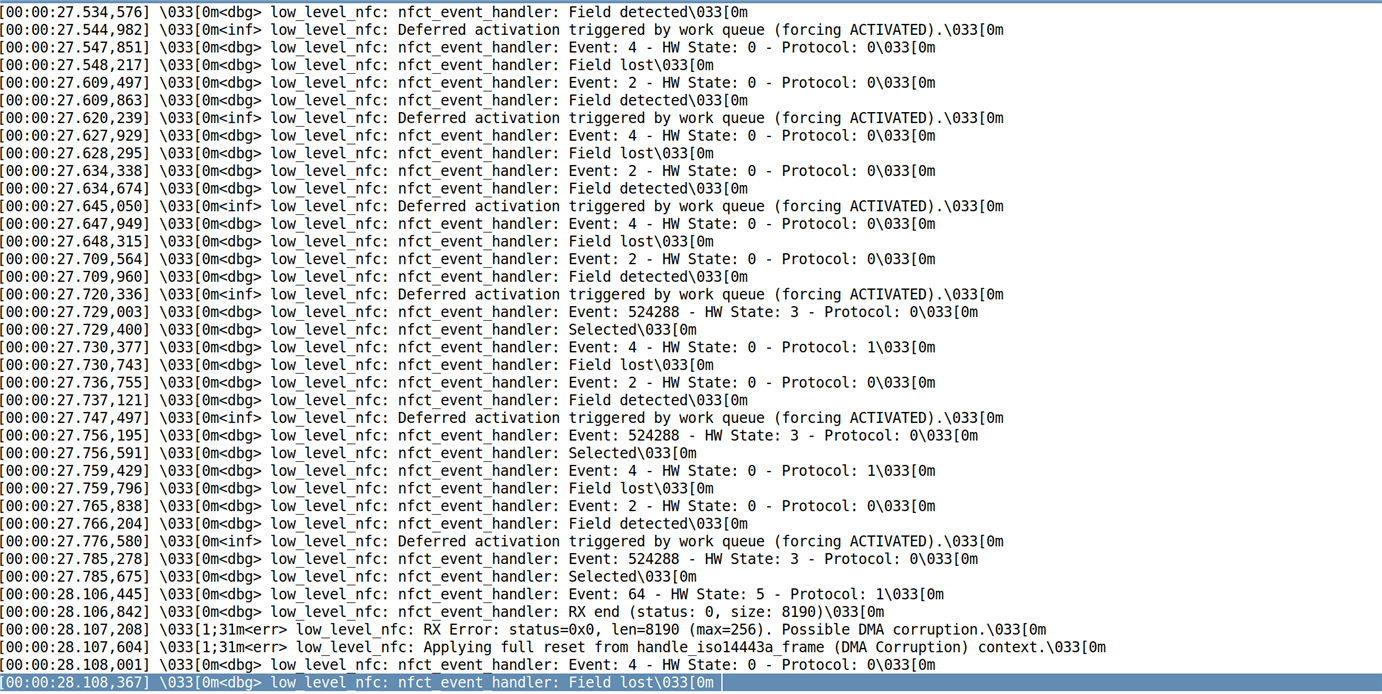

The primary issue occurs immediately upon **frame reception**. The **reported EasyDMA data length is consistently 8190 bits** (a known corruption value). This length is clearly incorrect and indicates a fundamental configuration or synchronization issue at the driver level. Crucially, data reception works correctly when using the recommended, full-stack NFC library, which confirms the integrity of the underlying hardware platform (nRF5340). Moreover, no consistent data are received.

    We do not have any sample code for using the NFC HAL The closest thing we have is looking at the nrfx NFC driver implementation as an example of how the HAL can be used if you want to use that directly. There is no example of using the nrfx driver either though, as this is handled by the NFC libraries which are the only approach we support in the SDK.
    Regarding the error, I agree that receiving 8190 bits is not possible (it is larger than the maximum Rx buffer size and what can be conveyed in the RXD.AMOUNT register. Can you share more details on your implementation and where this number comes from?

    Please find below my sample code.
    The size is retrieved from the event structure, and it matches the value of the RXD.AMOUNT NFCT register when the NRFX_NFCT_EVT_RX_FRAMEEND event occurs.

  • eI see. I do believe you, but I do not see how you can get 8190 in the RXD.AMOUNT. Can you share the exact raw value you read form RXD.AMOUNT a debugger in form of a screenshot or something similar? The reason is that this consists of two parts, adding up bytes and bits, and I do not see how you get get this value.
    I got an explanation about this meaningless value (8190). After the ISO 14443 selection, the PCD is supposed to send RATS, but we received 7 bits. In the HAL handler, there is the computation of the received length using the following function:
    NRF_STATIC_INLINE uint16_t nrf_nfct_rx_bits_get(NRF_NFCT_Type const * p_reg, bool crc_excluded) { uint16_t rx_bits = p_reg->RXD.AMOUNT & (NFCT_RXD_AMOUNT_RXDATABITS_Msk | NFCT_RXD_AMOUNT_RXDATABYTES_Msk); return (uint16_t)(rx_bits - (crc_excluded ? (8u * NRF_NFCT_CRC_SIZE) : 0)); }
    The RATS is supposed to have a CRC, so the content of the NFCT register should be 0x18 (3 bytes = 24 bits).
    Nevertheless, the HAL code is not protected: if the bit count is 7, then the number of bytes is 0. 0 - 2 (CRC size) = -2, which becomes 0x1FFE (8190) due to uint16_t underflow.
    The problem is still open, why I cannot receive the RATS?
    Best regards, Alain
    I found the issue: it was related to the protocol selection parameter. I needed to use NRF_NFCT_SELRES_PROTOCOL_NFCDEP_T4AT instead of NRF_NFCT_SELRES_PROTOCOL_NFCDEP.
    Now I receive frames correctly, and the problem is resolved.
    Thank you for your help!
    Alain
