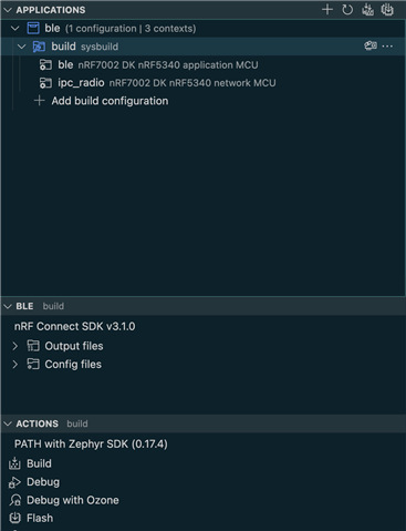

    These logs indicate that the application firmware is unable to communicate with the network core on the nRF5340:
    [00:00:03.515,136] <err> bt_hci_driver: Endpoint binding failed with -11
    [00:00:03.515,136] <err> bt_hci_core: HCI driver open failed (-11)
    Bluetooth init failed (err -11).
    Could you check if your flashed the merged image, or the sub-image? Make sure that the "build" catalog is selected in blue here, and not "ble" or "ipc_radio" before pressing "flash":

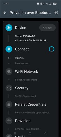

    It seems that the connection is done, but the App is trying to pair continuously:

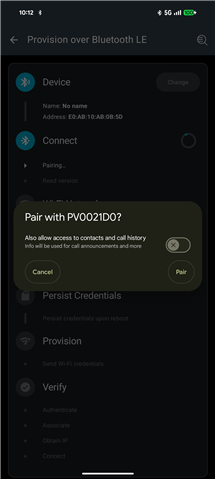

    Great to hear that you got some progression on this issue.
    There should be a pop-up with a pairing notification from the android system after connecting, like this:
    Before you can fill in your SSID/password, and crypto option.
    Could you check if there is any permissions on that app that is denied?
    Please note that if using WPA/WPA2 mixed mode selection, then there is a known issue on NCS v3.1.x at this time, and you will need to cherry pick this fix:
    https://github.com/nrfconnect/sdk-zephyr/commit/f72f7a27e923980e864dfa926c50545f7ecc9864
