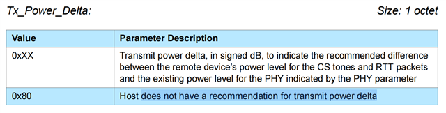

In bt_le_cs_set_procedure_parameters_param, the description of tx_power_delta appears to indicate the transmit power difference between the two devices. If the initiator’s TX power is 8 dBm and I would like the reflector to transmit at 6/4/0 dBm, should I adjust this parameter accordingly? For example, does setting tx_power_delta = 4 configure the reflector’s transmit power to 4 dBm?
This is how I am currently configuring it, but I am not entirely sure whether the reflector is actually transmitting at the power level implied by my tx_power_delta setting. Is there a recommended method to verify this?

    The tx_power_delta should be set to the transmit power difference in signed dB to indicate the recommended difference between the remote device's power level for the CS tones and RTT packets and the existing power level for the indicated PHY parameter. (0x80 should be set for no recommendation).

    Thank you for your reply. I revisited the Bluetooth Core Specification v6.0, Vol 4, Part E, page 2835. It indicates that this parameter represents the delta relative to the current PHY transmit power. In addition, the value should be provided in hexadecimal and interpreted as a signed value.
    For example, if my initiator TX power is 8 dBm and I want the peer to use 6 dBm, I should set the parameter to −2 (0xFE). In other words, 8 − 2 = 6.
    After applying this setting, it appears to be working as expected. If I have misunderstood anything, please let me know. Thank you.

  • That should be correct Cheng. Glad to hear it's working as expected now.
