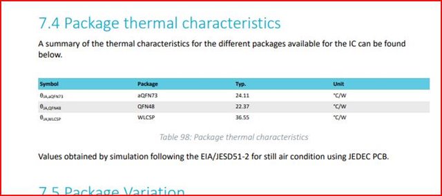

  •   I'm in the exact same boat. Any chance you guys can get the nRF52805 WLCSP °C/W number and can add that to the product specification?
    And the irony is if it even said 200°C/W we'd be pass, since there's no way this will fail compared to other items!  But without just about *any* number it's a no go.
