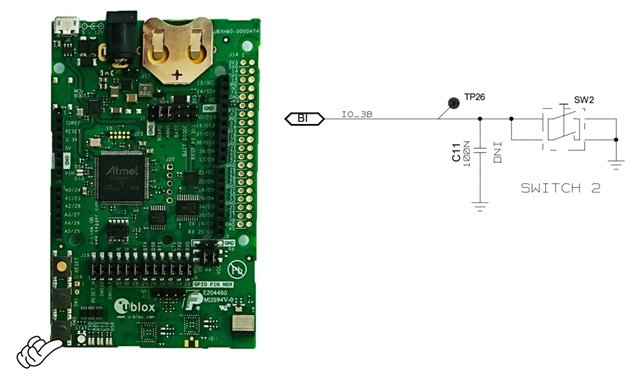

What I am noticing is that initially the idle current of the system will be low as expected around 4-5 uA. However, after a few seconds, the idle current will slowly start to increase and peak at around 500 uA. After some more time the idle current may continue to fluctuate between 4 uA - 500 uA seemingly at random. Functionality of the communication is not affected.
This behavior is observed on both the ANNA-B112 EVK and on a custom PCB board. On the ANNA-B112 EVK, if I touch the button SW2 with my finger (touch the button housing not press the button down) the idle current will very quickly go back down to 4-5 uA as expected and communication functionality is not affected.
(Note ANNA-B112 module IO_38 = nRF52832 P0.24)
I believe the issue is related to SPI and GPIOs communicating with the AD5940. If you notice, I use nRF52832 pin 24 for MISO and the ANNA-B112 EVK uses the same pin for SW2. I tried deleting the buttons definition on the .dts file, but this did not change the idle current fluctuation behavior.
I am not sure this is an EVK related issue because I am also noticing the same behavior on a custom PCB which has no button. For reference I don't use any external pullup or pulldown resistors on SPI, but I do use a 10K pullup for I2C.
What could cause the idle current to fluctuate like this when using SPI?

    Which SDK version are you using?
    To help narrow down the root cause, please try temporarily disabling the sense-edge-mask in your overlay file. You can either comment out the line or set the mask to 0. This will make the GPIO driver fall back to the default GPIOTE-based interrupt handling instead of the PORT/SENSE workaround.
    There is a known anomaly when using GPIOTE for input interrupts, but the extra current from that is only on the order of a few tens of uA much smaller than the ~500 uA jumps you are seeing. So this test is safe and useful for diagnosis.
    After removing the sense-edge-mask, please measure the idle current again. If the 4\5 µA to  500 uA fluctuations disappear, then we can confirm that the SENSE-based workaround is contributing to the issue. If the behavior is unchanged, we can rule it out and look elsewhere.
    This step will help us isolate whether the interrupt configuration on GPIO0 is causing the unexpected current spikes.
    Kind Regards,
    Abhijith
    Thank you for your response. However, I think I found a solution that solves the fluctuating current by making sure SCK, MOSI, and MISO are pulled down while not communicating. Here is how I updated my .overlay file.
    // SPI Pin Definitions
    	// SCK: nRF Pin 20 -> ANNA-B112 Pin 45
    	// MOSI: nRF Pin 19 -> ANNA-B112 Pin 35
    	// MISO: nRF Pin 24 -> ANNA-B112 Pin 38
    	spi1_default: spi1_default {
    		group1 {
    			psels = <NRF_PSEL(SPIM_SCK, 0, 20)>,
    					<NRF_PSEL(SPIM_MOSI, 0, 19)>,
    					<NRF_PSEL(SPIM_MISO, 0, 24)>;
    			bias-pull-down;
    	spi1_sleep: spi1_sleep {
    		group1 {
    			bias-pull-down;
    			low-power-enable;
    I used the line "bias-pull-down" which ensures that SCK, MOSI, and MISO are not floating. Now the current consumption stays at 4 uA and does not fluctuate when I touch the board or leave it alone for extended periods of time and communication still works correctly.
    Is it expected that these pins should be pulled down to minimize current consumption?
    Thank you,
    Crisvin K.
    Good to hear that.
    If you ask me whether it's mandatory, I would say no.However, from a hardware perspective, floating GPIO inputs can cause significant leakage current. So adding pull-downs on SCK/MOSI/MISO is a recommended low-power practice
