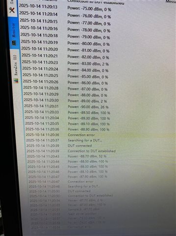

      Our product used nRF52840, we tried test nRF52840's BLE OTA RF performance with CMW500. After the nRF52840 device is assembled with the casing, it is inconvenient to route a serial cable for Bluetooth OTA testing via nordic's DTM (Direct Test Mode) mode. Therefore, we attempt to perform the OTA testing in the BLE connection mode of the CMW500.
      Our Bluetooth application is modified based on the NUS sample program "ble_app_uart" from the nrf5_sdk_17.1.0_ddde560. During the testing process, the CMW500 first searches and connects to the nRF52840, then gradually reduces the TX (Transmit) power. When the TX power drops below -85 dB, the BER (Bit Error Rate) becomes a non-zero value, and the BLE connection is subsequently disconnected abnormally. Following picture "nRF52840_OTA_test.jpg" shows the test log. This issue causes repeated reconnections during the OTA testing process, and the total OTA testing time increases severalfold.

  • the CMW500 first searches and connects to the nRF52840, then gradually reduces the TX (Transmit) power. When the TX power drops below -85 dB, the BER (Bit Error Rate) becomes a non-zero value
    If you continue to drop the TX-power , it will at some point lead to a disconnect.  So this would be expected behavior.
    If you don't want to reconnect - then either (1) Don't automatically re-start advertising after a disconnect , or (2) Don't automatically scan&connect to the peripheral after a disconnect.
