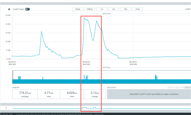

  • Thank you Hung Bui,
    I made some modifications based on this code, and now it works now, i want to use radio ready event and radio disabled event to set and clear gpio1.11(54L15).
    I haven't  tried myself but as far as I know MPSL provides pin debugging option that it toggles GPIOs based on  NRF_RADIO_EVENT_READY, NRF_RADIO_EVENT_DISABLED, NRF_RADIO_EVENT_ADDRESS, NRF_RADIO_EVENT_END.
    Could you take a look: https://github.com/nrfconnect/sdk-nrf/blob/v3.1.1/subsys/mpsl/pin_debug/mpsl_pin_debug_nrf54.c
    here is power profile with digital channel to sniffer the radio and gpio1.11, as below:
    here is the code:

    one question is, how could i know if the radio event is published already, i could not see radio event publish in this code.
    by the way please help to check if there is any problem in this code.

  • hi team,
    my purpose is using radio event to control the shared antenna. currently, this is only solution for customer right now.
    1. Yes, you are correct, need both event to toggle a pin, use this pin to control shared antenna.
    so basically, it is same as this:https://github.com/nrfconnect/sdk-nrf/blob/v3.1.1/subsys/mpsl/pin_debug/mpsl_pin_debug_nrf54.c
    but, only one pin for EVENT_READY and EVENT_DISABLED.
    Please clarify now you have NRF_RADIO_EVENT_READY  and NRF_RADIO_EVENT_DISABLED they can both toggle a GPIO when the events occur, correct ?
    2. i don't need a interrupt handler, nothing to do, just toggle a pin, so using gppi and dppi,
    Are you talking about having the radio interrupt handler in the code ? I don't think it's possible
    3.there is a problem when using coex pins, because external wifi could not grant the antenna correctly.
    when external wifi works with tx function, grant is noraml, but when external wifi works with rx function, grant is abnormal. so iam looking for a solution for it.

  • Hi William,
    I'm sorry that it taking long time to solve the issue. But you need to tell us more clear on what works and what not works and what you need.
    You mentioned yesterday that "I made some modifications based on this code, and now it works now, "
    So could you declare what works and what doesn't work now ? From what you showed in the trace seems that the pin is toggled correctly when the radio enters RX and then after that TX ?
