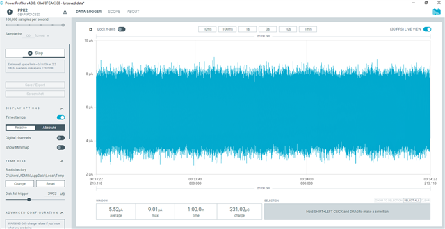

I’m working on reducing power consumption on the nRF54L15 and aiming for an idle current of around 3 µA, as shown in Nordic’s documentation.

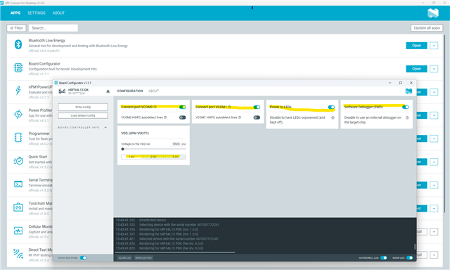

With the SDK v3.0.1 hello_world project, I consistently measure an average current of approximately 5.5 µA. Despite disabling all possible peripherals, the current level remains the same.
I have included the project file for reference.
Additionally, any recommended Zephyr settings or example configurations would be very helpful.

  • Hi Kenneth,
    I observed that the power consumption drops to around 1.5 µA when using the system_off example, but that example completely powers down the system and causes a full restart when an interrupt occurs.
    In my case, I need the device to enter a system-on idle state, so that execution continues from where it stopped after waking up—without a restart.
    According to the documentation, this system-on idle mode should achieve around 3 µA. Please correct me if I’m misunderstanding anything.
