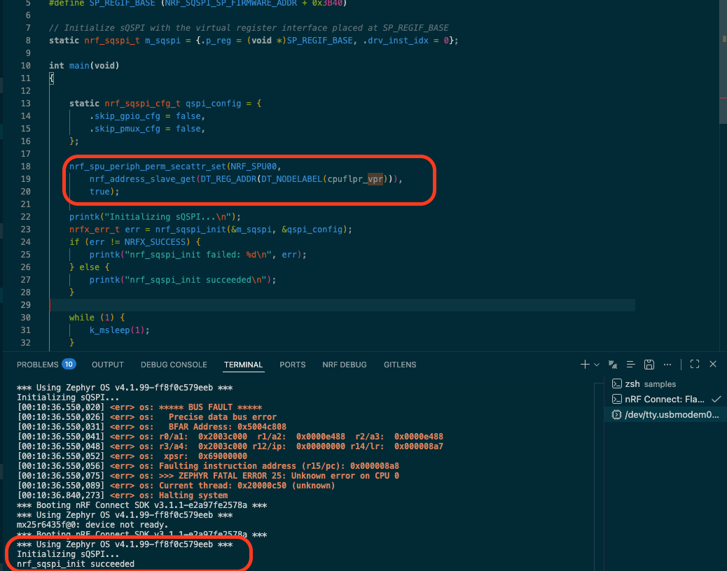

Bus Fault
When running this I get
00> Initializing sQSPI...
00> [00:00:00.001,948] <err> os: ***** BUS FAULT *****
00> [00:00:00.001,954] <err> os: Precise data bus error
00> [00:00:00.001,958] <err> os: BFAR Address: 0x5004c808
00> [00:00:00.001,968] <err> os: r0/a1: 0x2003c000 r1/a2: 0x0000e1f1 r2/a3: 0x0000e1f1
00> [00:00:00.001,974] <err> os: r3/a4: 0x2003c000 r12/ip: 0x00000000 r14/lr: 0x000008b3
00> [00:00:00.001,978] <err> os: xpsr: 0x69000000
00> [00:00:00.001,982] <err> os: Faulting instruction address (r15/pc): 0x000008b4
00> [00:00:00.001,999] <err> os: >>> ZEPHYR FATAL ERROR 25: Unknown error on CPU 0
00> [00:00:00.002,013] <err> os: Current thread: 0x20000c48 (unknown)
00> [00:00:01.152,448] <err> os: Halting system
Debugging shows this happens at the nrf_vpr_initpc_set() call in nrf_sqspi.c. the init_pc pointer is set to 0x2003C00, same as in the MSPI
Is this some RAM configuration issue? But the differences to the MSPI example are minimal.
