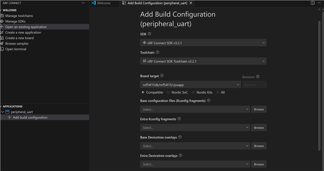

  • Hi Brian
    Are you using the VS Code extension to build the project? What board are you building the application for here? Start with the nRF54L15 DK and upload the full build log here. if you see the same issue. Also, make sure you have the same version of the nRF Connect SDK as the toolchain when you build.
    Here's how the build page should look if you're building the project with the VS Code extension:
    Simon

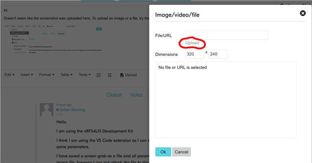

    I am using the nRF54L15 Development Kit
    I think I am using the VS Code extension as I can see the same screen as per the image you have attached with the same parameters.

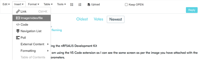

    I have saved a screen grab as a file and all parameters are the same as per your image.  I have tried to attached the image file, however I can not attach the file to this message. I have tried Insert\image/video/file\File/URL   I enter the complete path C:\Users\Brian\OneDrive\Desktop\IMAGES  followed by the full file name and nothing can be uploaded.
