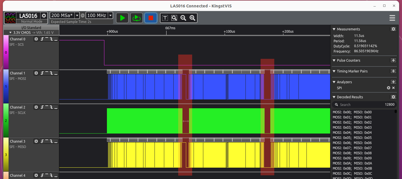

nrf5340 SPI/nrf-spim: 11 us delay between each buffer in a spi_buf_set
There seems to be a weird delay of around 11 us between each buffer in a spi_buf_set as shown in the red regions in the image below:
The test involves a transfer of 100 buffers of 128 bytes each using spi_transceive_signal on a nrf5340-DK using spi4 @8Mhz.
Is there a way to avoid this delay ?
SPI delay between buffers
