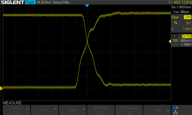

Eventually I wrote a loop in main() that simply toggles the gpio P1.04 alternating high and low once per millisecond. When I look at the signal on the oscilloscope it the rise and fall times are good (about 15ns). If I force the drive strength to H0H1 the rise and fall times are about 7ns. This says to me that the hardware is all good, both inside the chip, and on my external wiring. From the rise and fall times, and the  rise and fall times published in the datasheet, I can estimate that the capacitance on the line is about 22pF, which seems about right.

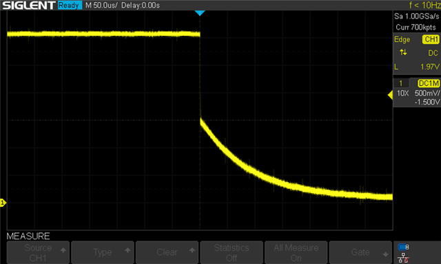

Now here is where it gets weird. if I put a break point i the middle of the loop, the rising edge looks great, but the falling edge is very bad. the signal falls the from 3.3V to 1.7V at the normal rate, then the pin goes tristate. It then slowly falls to zero over about 200uS, this is exactly the time you would expect with 22pF and a 10MOhm pull-down, the scope probe is a 10MOhms resistance to ground..
When the processor comes out of reset and attempts to send the reset pulse to the pcal6408a it drives down to 1.7V, then goes tri-state, this is why the pcal6408a never properly resets, and also why I could never catch the reset pulse on the oscilloscope.

    First an oscilloscope plot of the loop running with no break points. time base is 20nS/division
    Then a scope shot of the falling edge when it fails (the first time as the pcal6408 is initializing, or when there is a break-point in the main loop at the sleep call. Note the change in timebase to 50uS/div.

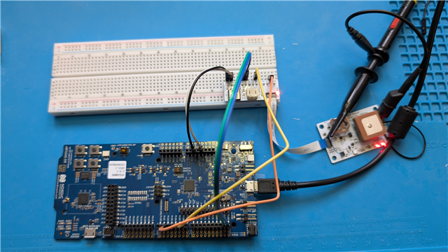

    The test program only needs an overlay to describe the pins and connections. Here is my test setup: The white boards are my design. The small one on the breadboard is a breakout to the flex circuit, and the board near the 'scope probe is a sensor board.

  • I finally got to the bottom of this. I had an error on my schematic, which inadvertently attached P1.04 to a power domain that was not powered up correctly. The slow fall was due to the current limit on P1.04 limiting the rate of discharge on the capacitors on the power domain.
