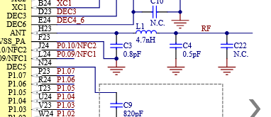

I was hoping to ask 2 questions about my design choices when designing around the nRF52840, specifically the QIAA-R branch.
First, I am confused on as to which reference design I should use, out of the 7 provided. I was going with 1, but I am reading some conflicting things about how ref. 1 is for the pcb antenna. In my application, I will be running it as a meshtastic node, with a battery as the main supply and usb as fallback/charger when connected (so I'm also looking to have a power priority type of thing, I don't know if this can be done internally or I need an external ic for this), and also as a programmer. I was looking to use an external ipex antenna or a chip antenna for the BT. Which layout should I go with in this case?
Also, the reference states I dont need the DEC5 cap (C9 820pF), for revisions Fxx and newer, but on the my distributors listing, there is no current stock revision code. I am buying components from LCSC and getting it manufactured by JLCPCB. When I manufacture with JLC, they charge extra for "extended components", their way of saying irregular values or components, and 820pF is considered a irregular value. I was hoping I could just avoid the extra charge, but I don't know if my distributor has the right hw revision. Do I have to inquire about that or is there a way I can tell?
