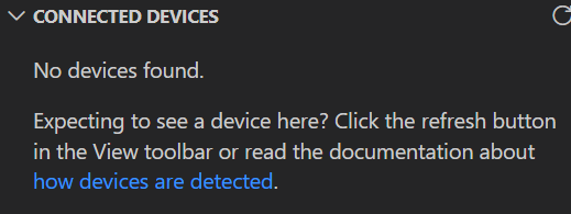

nrfutil cannot recognize J-Link, preventing flashing with nrfutil and preventing VS Code from recognizing the device.
Dear Support Team,

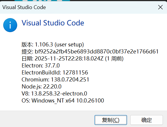

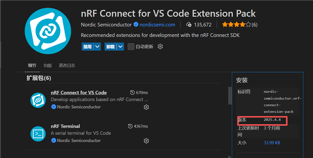

I have downloaded the latest version of VS Code;
I have also installed the latest version of the nRF Connect for VS Code Extension Pack;
The J-Link version is v8.78;
The SDK and toolchain are v3.1.1;
However, the nRF54L15-DK device is not displayed under CONNECTED DEVICES in VS Code (I have verified that the development board is functioning correctly).

  • Hi Zero,
    I see from the log that one J-Link device is found. Can you run the command "nrfutil device list" and share the result here? If you do not see ny device then, can you check with a different USB cable in case there is a problem with the cable? Also please verify that the on/off switch on the DK is so that it is on, and that you see an active LED on the DK (the LED for the onboard debugger).
    I have already replaced the USB cable with one that is known to be working, and I have also confirmed that the development board is receiving power properly.
    BR,
    Zero

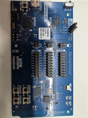

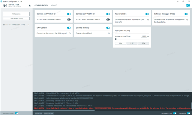

    I see, this does not look correct. Can you use the Board configurator and make sure SWD is enabled on the DK?
    If that does not work, can you share a screenshot from the Board configurator as well so that I see the configuration? And lastly, can you let me know if you have a DK or PDK, and the version that is printed on it? (A photo of the DK would also give this information).
    Edit: can you also run "nrfutil device list --log-level trace" and upload the log from C:\Users\<USER>\.nrfutil\logs\nrfutil-device.log here? (Replace <USER> with your username on the local machine).
