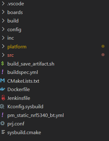

Issue 1 — Network core image not building
Following the migration guide, we initially created:
  • sysbuild.conf with:
SB_CONFIG_NETCORE_HCI_IPC=y SB_CONFIG_PARTITION_MANAGER=y
  • sysbuild.cmake file
However, the network core image was not getting built, and build failed with errors.
Issue 2 — Dynamic partition is not working
To resolve the first issue, we removed sysbuild.conf and instead added kconfig.sysbuild.
After this change:
Heavy check mark Network core image is now building correctly

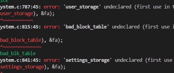

 X Dynamic partition still fails, showing the same partition-manager related build error.
787:45: error: 'user_storage' undeclared (first use in this function)
  787 |         err = flash_area_open(FLASH_AREA_ID(user_storage), &fa);
815:45: error: 'bad_block_table' undeclared (first use in this function); did you mean 'bad_blk_table'?
  815 |         err = flash_area_open(FLASH_AREA_ID(bad_block_table), &fa);
      |                                             bad_blk_table
841:45: error: 'settings_storage' undeclared (first use in this function)
  841 |         err = flash_area_open(FLASH_AREA_ID(settings_storage), &fa);
We expect partitions to be dynamically generated when using sysbuild, but it appears partition manager is not active or parameters are not being picked up.

pm.yml is bellow
app:
  address: 0x00000000
  size: 0xE8000       # 928 KB
memfault_storage:
  address: 0x000E8000
  size: 0x10000         # 64 KB
  placement:
    region: flash_primary
    after: [app]
bad_block_table:
  address: 0x00F8000
  size: 0x2000         # 8 KB
  placement:
    after: [memfault_storage]
settings_storage:
  address: 0x000FA000
  size: 0x2000         # 8 KB
  placement:
    after: [bad_block_table]
user_storage:
  address: 0x000FC000
  size: 0x4000         # 16 KB
  placement:
    before: [end]
