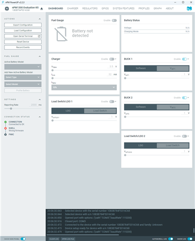

Hi there, I've a following set:
  • nPM1300-EK (PCA10152 / 1.3.0 / 2025.18 / Serial no. 10B3B784F5316C68)
  • nRF Connect v5.2.0
  • nPM PowerUP v2.2.3
After launching nPM PowerUP and before selection a board in the left top corner of the App, you can see the log:
19:53:33.283 Initialising the bundled nrfutil device
19:53:33.681 Using the bundled core version for nrfutil device: 8.1.1
19:53:33.721 Using nrfutil device version: 2.12.8
19:53:33.722 Using nrf-device-lib version: 0.17.87
19:53:33.723 Using nrf-probe version: 0.44.0
19:53:33.723 Using SEGGER J-Link version: JLink_V8.76
19:53:33.726 Your version of SEGGER J-Link (8.76) is newer than the one this app was tested with (8.42). The tested version is not required, and your J-Link version will most likely work fine. If you get issues related to J-Link with your devices, use the tested version.
19:53:33.781 Getting serial port options from the persistent store for 10B3B784F5316C68.pc-nrfconnect-npm
19:53:33.782 Device connected with the serial number 10B3B784F5316C68
19:53:33.782 Device Connected SN:10B3B784F5316C68
After the board is selected the pop-up window with two options (NO and PROGRAM) appears.
20:04:34.593 Selecting device with the serial number 10B3B784F5316C68
20:04:34.720 Selected device with the serial number 10B3B784F5316C68
20:04:34.720 Selected device with s/n 10B3B784F5316C68
20:04:34.726 Opened port with options: {"path":"COM3","baudRate":115200}
20:04:34.813 Closed port: COM3
If you select PROGRAM, nothing happens and the following log appears
20:06:10.389 Error: Failed with exit code 1. Subprocess C:\Users\admin\AppData\Roaming\nrfconnect\nrfutil-sandboxes\8.1.1\device\2.12.8\bin\nrfutil-device.exe failed with unexpected exit code Some(-1073741819)
20:06:10.389 Error while setting up device with the serial number 10B3B784F5316C68
20:06:10.389 "Failed with exit code 1.\nSubprocess C:\\Users\\admin\\AppData\\Roaming\\nrfconnect\\nrfutil-sandboxes\\8.1.1\\device\\2.12.8\\bin\\nrfutil-device.exe failed with unexpected exit code Some(-1073741819)\n"
20:06:10.390 Deselected device
If you select NO, three steps appear on the left side of the CONNECTION STATUS panel:
  • CONNECTION = Connected to EK;
  • SHELL = Wrong firmware;
  • PMIC = without any status, grey colored.
And log is following:
20:04:50.236 Connected to the device with the serial number 10B3B784F5316C68 and family: Unknown
20:04:50.237 Device setup ready for device with s/n 10B3B784F5316C68
20:04:50.242 Opened port with options: {"path":"COM3","baudRate":115200}

    I don't have any good suggestion, other than possible double check the user guide if you have connected according to the description:
    https://docs.nordicsemi.com/bundle/ug_npm1300_ek/page/UG/nPM1300_EK/use_ek_power_up.html
    Possible also try from another PC just for test.
    Let me know if you make it work,
    Kenneth
