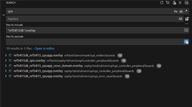

The current problem is that the program will permanently freeze after the nrfx_spis_buffers_set is executed (or is in execution), and will never print "222". It seems to be waiting for some kind of receiving signal? It is certain that if only the nrfx_spim_xfer function is called, the correct SPI waveform can be detected by the logic analyzer. However, once both the sending and receiving functions are enabled simultaneously, the above problem will occur. Are there any special conditions for the SPIS reception of nRF54L15 that I have ignored? Looking forward to your reply
