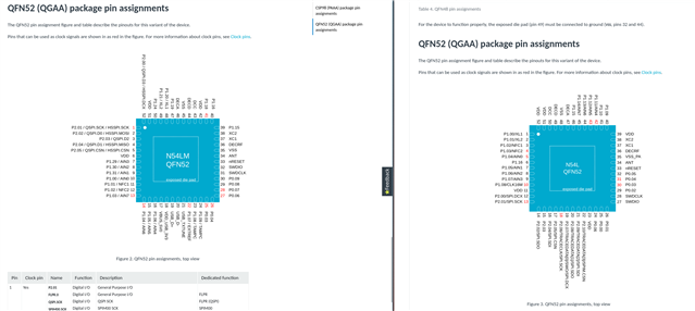

Can you please tell if any of the packages of thes ICs are pin to pin - nrf54L15 and nrf54Lm20 ?
regards
vivek

Are you asking if the nRF54L15\10\05 has a package that is pin compatible with nRF54LM20?
The two products shave one package type, the QFN52 QGAA,
They are not Pin compatible
Jonathan
