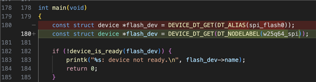

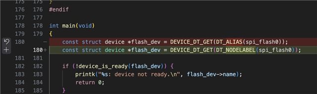

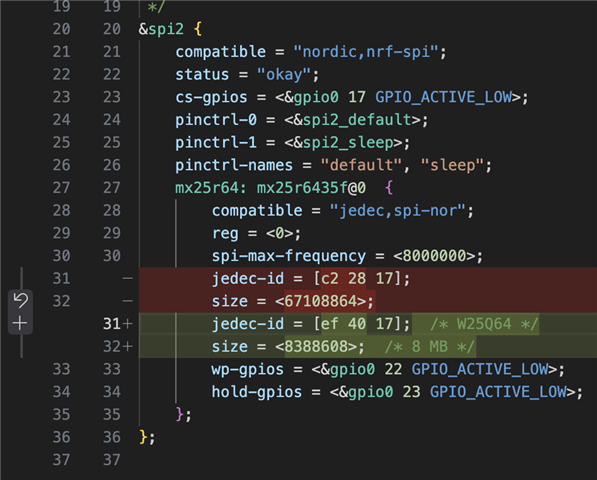

    I've tried this overlay with both the jesd16 and spi_flash samples, no luck with either. In both cases I edited the overlay slightly to have the matching jedec-id and size as the w25q64 flash. I've also made sure to include this overlay and the relevant .conf file in the build configurations for both projects. I made no changes to main.c in the jesd16 sample.
    In spi_flash I also named the device `spi_flash0` commented out the `/delete-node/ &mx25r64;` line from the overlay, and used DT_NODELABEL instead of DT_ALIAS when getting the device from devicetree in main.c. I've also moved the flash pins to match the pins for spi2.

  • Apologies for making things unnecessarily confusing, as mentioned in that quoted section I renamed the device in the overlay to `spi_flash0` in the spi_flash sample. In both samples I've made sure the DEVICE_DT_GET(DT_NODELABEL()) call matches the name of the device from the overlay, as they will not build if there is a mismatch.
    Yes I edited the overlay for w25q64 based on the example. Here is that overlay after the change:

  • Hi there,
    First, thank you so much for all the help so far!
    I’ve done a ton of testing in the last few days and identified a few issues with my setup.
    First, I had the wrong DK selected as the build target in the build configuration. I had selected one of the other NRF52840 dk’s (nrf21540dk_nrf52840 I think), but not the NRF52840DK_NRF52840 configuration I should have been using.
    Second, some of the jumper cables that I am using appear to be faulty. I’ve swapped them out and the read/erase/write tests from spi_flash sample are now working!
    That being said, I believe I am at a similar starting point to the ticket you linked, where the flash operations work but the device still does not show ready. I’ve tried adding a 1 second delay (longer than necessary I imagine) to the beginning of main.c so the flash has time to power up before checking device_is_ready, but this did not work. I see the user’s solution was to “add a snippet to turn on the voltage before the jedec ID is checked,” but I’m unsure how to do that.
