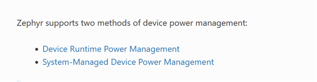

  • thanks for your very helpful assistants,
    zephyr doc states:
    yet the proj.conf has two define we can play with
    CONFIG_PM_DEVICE=y
    CONFIG_PM_DEVICE_RUNTIME=n
    do I understand correctly?
    if CONFIG_PM_DEVICE_RUNTIME=n
    then use:
    pm_device_action_run(uart, PM_DEVICE_ACTION_SUSPEND);
    pm_device_action_run(uart, PM_DEVICE_ACTION_RESUME);
    if CONFIG_PM_DEVICE_RUNTIME=y
    then use:
    pm_device_runtime_enable(uart);
    pm_device_runtime_put(uart);
    pm_device_runtime_get(uart);
    etc..
    Also the pm_device_runtime_enable won't enable when CONFIG is n.
    What is recommendation when to use one, or both CONFIG settings.
    thanks
    Dan
