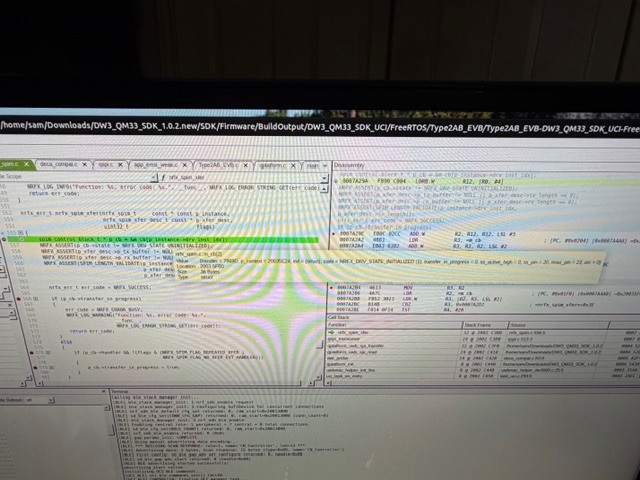

    i have two different results from debugging
    1.
    so, if I stop in the weak app_error_fault_handler
    id = 0x1001  = NRF_FAULT_ID_APP_MEMACC
    and the PC s 8093a , which is about halfway thru nrfx_spim_xfer
    the info value is 1

    2.

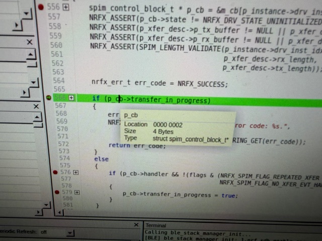

    if I step in more
    rfx_err_t nrfx_spim_xfer(nrfx_spim_t const * const p_instance,
    nrfx_spim_xfer_desc_t const * p_xfer_desc,
    uint32_t flags)
    spim_control_block_t * p_cb = &m_cb[p_instance->drv_inst_idx];  <-------- this drv_inst_idx member doesn't appear in the popup for p_instance, I can see it before the call to  xfer
    NRFX_ASSERT(p_cb->state != NRFX_DRV_STATE_UNINITIALIZED);
    NRFX_ASSERT(p_xfer_desc->p_tx_buffer != NULL || p_xfer_desc->tx_length == 0);
    NRFX_ASSERT(p_xfer_desc->p_rx_buffer != NULL || p_xfer_desc->rx_length == 0);
    NRFX_ASSERT(SPIM_LENGTH_VALIDATE(p_instance->drv_inst_idx,
    p_xfer_desc->rx_length,
    p_xfer_desc->tx_length));
    nrfx_err_t err_code = NRFX_SUCCESS;
    if (p_cb->transfer_in_progress)  <---- p_cb = 0x00000002
    err_code = NRFX_ERROR_BUSY;
    NRFX_LOG_WARNING("Function: %s, error code: %s.",
    __func__,
    NRFX_LOG_ERROR_STRING_GET(err_code));
    return err_code;
    else
    if (p_cb->handler && !(flags & (NRFX_SPIM_FLAG_REPEATED_XFER |
    NRFX_SPIM_FLAG_NO_XFER_EVT_HANDLER)))
    p_cb->transfer_in_progress = true;   // this faults... setting low memory.(0x00000002).
    I see in the popup, its m_cb[2].. so it saw drv_inst_idx
    but p_cb ends up being 2?????
