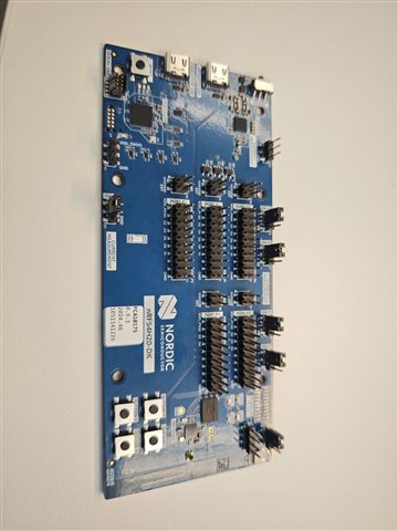

    I believe I have nRF54H20 DK v0.7.0 (you can check the DK in the attached image). I believe I've connected all the jumpers that I possibly can.

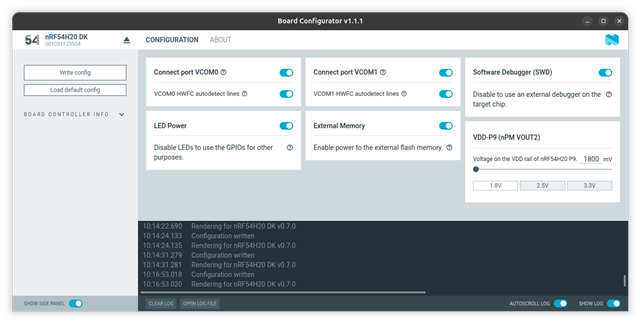

    For Ironside SE: I'm using nrf54h20_soc_binaries_v23.1.2+21.zip
    Here is my board configuration

    Kittitouch
  • Hi
    The image you uploaded shows a v0.9.1 DK (see the sticker for future reference).
