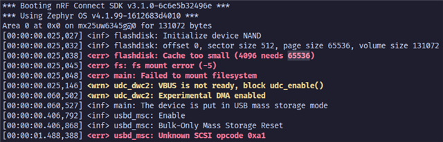

  • Hi Simon,
    Sorry for not including the error evidence earlier - DevZone went into maintenance and I might forgot to add it. Let me start fresh.

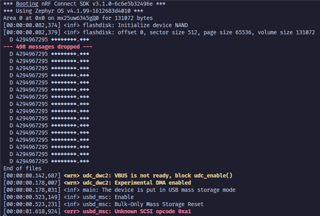

    With cache size 4096: The filesystem fails to mount (see attached). I'm unsure if this is a flash or exmif interface issue.
    With cache size 63356: The mount error disappears. I checked dropped messages - nothing unusual.

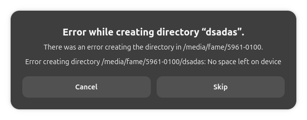

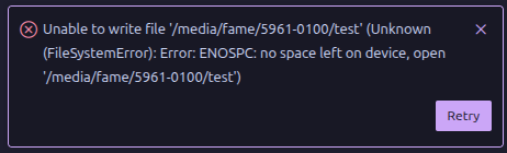

    File creation issue: When I create a file from OS I get no logs at all (see attached). but I got the error from OS.
    This is when I created a file in vscode.

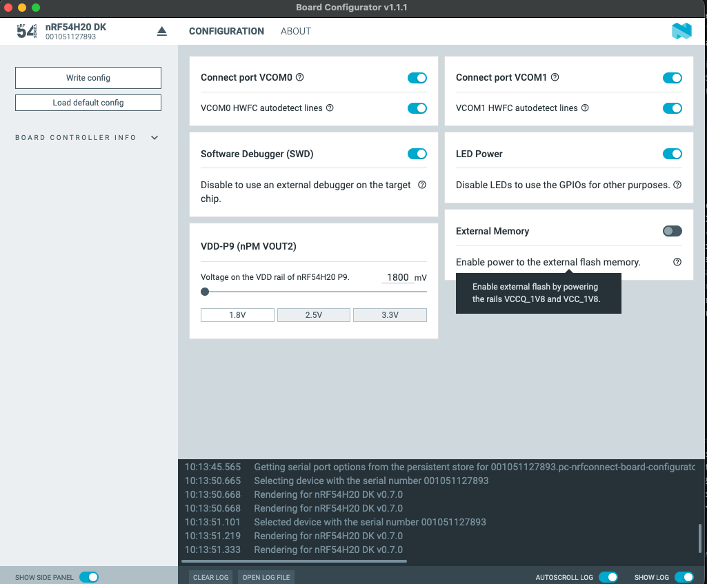

  • Hi again
    1. That must be because a 4096 cache size is too small for the FS.
    2. I see from the log here that the device is initialized as a NAND device, but the external flash you're using ( the MX25UW63) is a NOR flash series device. Or have you just named the disk NAND? You're using the onboard external flash device, correct? If so, can you check in the nRF Connect for Desktop board configurator app that the External flash is powered by setting the switch here to ON
    Simon

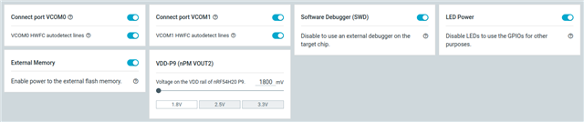

  • Hi Simonr,
    Thanks for the help. I tried turning on the External Flash power in the board configurator, but I’m still getting the same error.
