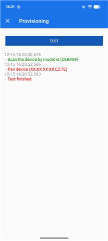

However, when we try the "Provisioning" test in the Eddystone test set of the Google Fast Pair Validator app, the test fails. The test was started both with the device unprovisioned via the Find Hub app and reset (turned off then on), as well as with the device freshly flashed. The tester app was running on Google Pixel 6 with Android 16 and OnePlus 3 with Android. We also tried with the ADB command for locator tags that do not create a bond during pairing activated and deactivated, but there was no difference in the output. Honestly not sure which of the two applies to the Locator Tag example.

And a screenshot of the validator app:

  • Hi Hung Bui,
    thanks for the fast answer, I changed the line and the "Provisioning" test passed. Perfect, thank you very much.
    I was looking for that exact fix myself, but was unable to find the specific file, even though I was given the unique Log message "Key discarded (timeout)" from a certain module called fast_pair. Any tips from your experience on how to approach such a problem in the future? Could save you guys from a few questions ;)
    Cheers and happy holidays to your team!
