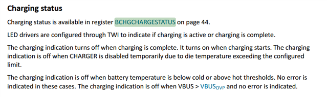

    Can you please shed some light on the battery detection functionality in the nPM1300, if such a function exists in the present silicon that we use in our boards?
    I have just discovered that the v1.2 version of the nPM1300 datasheet has removed the battery detection function and status info all together, does this mean that from a certain silicon revision of the IC the battery detection has been removed?
    Lastly, I'd appreciate it if you please clarify what the necessary conditions are for a Li-Ion battery to connect to the power distribution path VBAT->VSYS and also the in-built down-stream regulators (LDO and DCDCs). What I mean by that is e.g. does the host MCU need to configure the nPM1300 with charging mode enabled for the battery to connect to the supply inputs and also VSYS?
