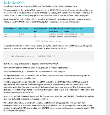

I am using the nrf52840 in QFAA package, and the external DMIC example receives audio data through the PDM interface. I noticed that the official documentation mentions support for EasyDMA. How can I use the DMA mechanism, and are there any related example codes available?
  • There is a "DMIC" audio sample in NCS SDK that should demonstrate how to use the driver interface.
    DMA is used internally by the driver.

    The official example code does not use DMA. The datasheet for the nRF52840 only covers the hardware configuration for this part and does not provide specific configuration functions.
  • It very much does use DMA internally since that is the only way you can actually get audio data out of the peripherial.
    Code above does not show anything that is actually happening in drivers. Try running it in a debugger.
    I strongly recommend using the driver (and not NRFX stuff directly) here as it solves the otherwise non- trivial audio buffering issues.
  • Are you saying DMA is enabled without any configuration? The example code can be flashed normally, but it doesn't seem to be using the DMA mechanism, right?
    Have you tried to run the sample in a debugging session like Turbo J suggested?
