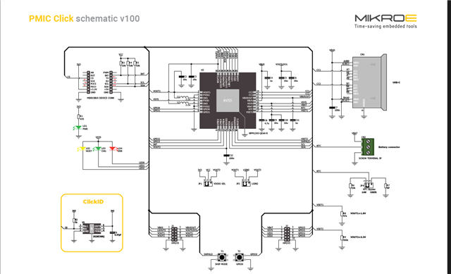

nPM1300 MIKROE Click – VDDIO_SEL = VOUT2 shows 3.3 V but board does not power up, VBUS not detected, I2C not working
I am using the nPM1300 MIKROE Click board with an ESP32 over TWI (I2C).
I am facing an issue when VDDIO is sourced from VOUT2 using the onboard VDDIO_SEL jumper.
Although VOUT2 and VDDIO both measure 3.3 V, the PMIC Click board does not fully power up, VBUS is not detected, and I2C register read/write fails.
When I supply external 3.3 V from ESP32, everything works as expected.

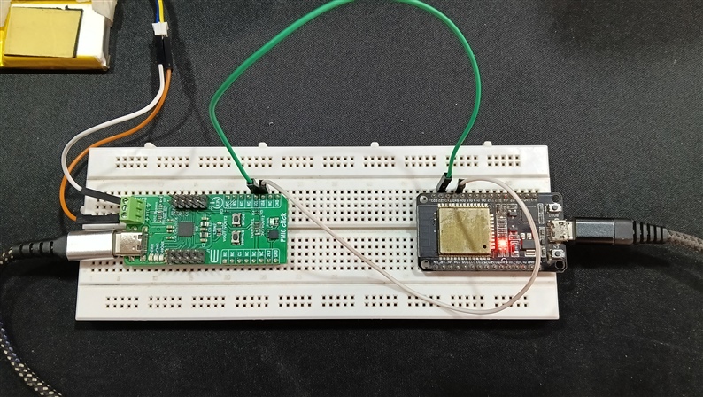

Hardware Setup
  • PMIC: nPM1300 (MIKROE Click Board)
  • MCU: ESP32
  • Interface: TWI / I2C
  • Battery connected to VBAT
  • NTC connected using 10 kΩ resistor
  • Observed Behavior
    • VOUT2 = 3.3 V
    • VDDIO = 3.3 V
    •  Board does not power up
    •  Power LEDs do not turn ON
    • VBUS not detected
    • I2C registers cannot be read/write

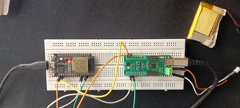

  • Working Case
    If I supply external 3.3 V + GND from ESP32 to the Click board:
    • Board powers ON
    • LEDs turn ON
    • VBUS detected
    • I2C registers read/write correctly
Question
Is VDDIO from VOUT2 a supported startup configuration, or is external VDDIO required for initial PMIC bring-up?
Could this be a power-up dependency issue where VOUT2 needs I2C configuration but I2C needs VDDIO?
