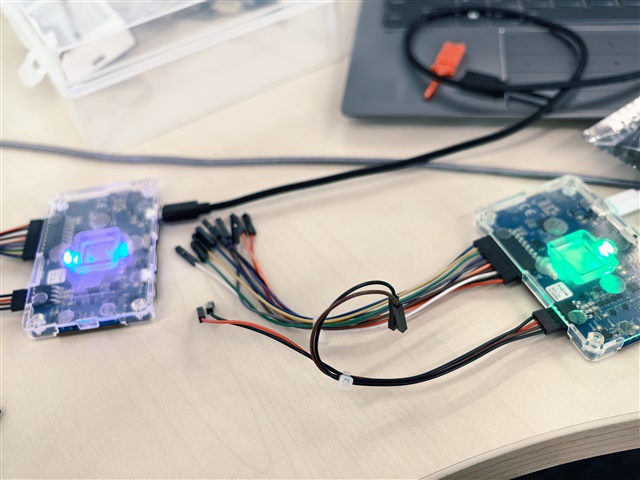

All of the following used the same power supply to power our development board and measure the current of the development board:

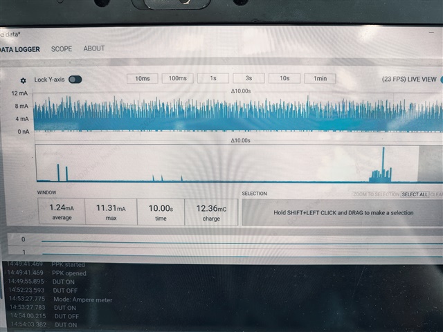

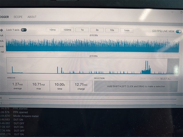

The PPK2 I purchased measured an average current of 1.27mA. The results were consistent when the program selected 1s, 3s, and 10s.
Using another PPK2 of the same model, the average current was measured to be 1.24mA. The results were consistent when the program selected 1s, 3s, and 10s.

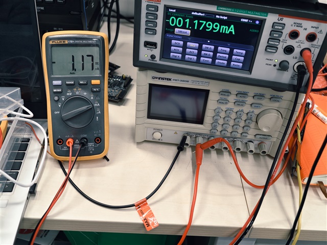

Using a high-precision ammeter, the current was measured to be 1.18mA.

  • One thing to check for the desktop multimeter, is it averaging over longer time? There are a lot of short pulses on the current flow with the Nordic devices and without this longer filtering time (we use 1s with Agilent meters) then you more or less always get incorrect readings.
    But as Simon says, this is high compared to the spec but inside. Normally we see less than a couple of percents off.
