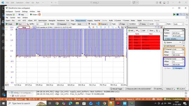

    The -11 return value corresponds to -EAGAIN and indicates that the I2S TX queue is full and the operation timed out. This occurs when the application submits audio blocks faster than the I2S hardware can transmit them.
    Increasing NUM_BLOCKS (for example to 8) is the recommended first step to provide additional buffering. If the issue still occurs, you may also increase the .timeout value in your i2s_config to allow i2s_write() more time to wait for a free TX slot. Please confirm if it works. Thanks
    Best Regards,
    Syed Maysum

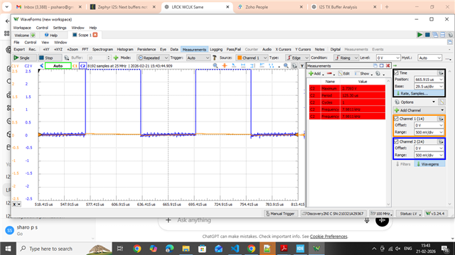

  • Not working sir,
    new issue is get ,
    I have to share my code here
     * Codec-style I2S SLAVE playback using k_mem_slab
     * nRF54Lx DK

        struct i2s_config cfg;
        int ret;
        printk("I2S playback (mem_slab)\n");
        // clocking and codec init
        ret = pwm_4mhz();
        if (ret < 0)
            printk("PWM init failed\n");
            return ret;
        for (int i = 0; i < 20; i++)
            ret = i2c_init_codec();
            if (ret == 0)
            k_msleep(5);
        if (ret < 0)
            printk("Codec init failed\n");
            return ret;
        k_msleep(10);
        // printk("BLOCK=%d  SAMPLES=%d\n", BLOCK_SIZE, SAMPLES_PER_BLOCK);
        if (!device_is_ready(i2s_dev))
            printk("I2S not ready\n");
            return -ENODEV;
        // I2S CONFIG
        cfg.word_size      = SAMPLE_BIT_WIDTH;
        cfg.channels       = CHANNELS;
        cfg.format         = I2S_FMT_DATA_FORMAT_I2S;
        cfg.options        = I2S_OPT_FRAME_CLK_SLAVE |
                             I2S_OPT_BIT_CLK_SLAVE;
        cfg.frame_clk_freq = SAMPLE_RATE_HZ;
        cfg.block_size     = BLOCK_SIZE;
        cfg.timeout        = TIMEOUT_MS;
        cfg.mem_slab       = &i2s_tx_slab;
        ret = i2s_configure(i2s_dev, I2S_DIR_TX, &cfg);
        if (ret < 0)
            printk("I2S config failed\n");
            return ret;
        printk("Start streaming\n");
        //prefill
        for(int i = 0; i < 30;i++)
            void *block;
            k_mem_slab_alloc(&i2s_tx_slab, &block, K_FOREVER);
            fill_block((int16_t *)block);
            i2s_buf_write(i2s_dev, block, BLOCK_SIZE);
        ret = i2s_trigger(i2s_dev, I2S_DIR_TX, I2S_TRIGGER_START);
        k_msleep(1);
        if (ret < 0)
            printk("I2S trigger failed\n");
            return ret;
        while (1)
            void *block;
            ret =   k_mem_slab_alloc(&i2s_tx_slab, &block, K_FOREVER);
            if (ret != 0)
              //k_yield();
                continue;
            ret = i2s_buf_write(i2s_dev, block, BLOCK_SIZE);
            if (ret == -ENOMEM)
                k_mem_slab_free(&i2s_tx_slab, block);
                printk("free=%d\n", k_mem_slab_num_free_get(&i2s_tx_slab));
                continue;
            // else if (ret < 0)
            //     printk("I2S error %d\n", ret);
            //     i2s_trigger(i2s_dev, I2S_DIR_TX, I2S_TRIGGER_DROP);
            //     k_sleep(K_MSEC(5));
            //     i2s_trigger(i2s_dev, I2S_DIR_TX, I2S_TRIGGER_PREPARE);
            //     k_sleep(K_MSEC(2));
            //     i2s_trigger(i2s_dev, I2S_DIR_TX, I2S_TRIGGER_START);
            //     k_mem_slab_free(&i2s_tx_slab, block);
            //     printk("free=%d\n", k_mem_slab_num_free_get(&i2s_tx_slab));
            //     continue;
         i2s_trigger(i2s_dev, I2S_DIR_TX, I2S_TRIGGER_DROP); // stop playback
         printk("Stopped\n");
        return 0;

    I get Mic sound , but during I2s Transmission shows
    Log:

  • I am uploadede Bclk and wclk digram is pefect but mclk 4 mhz but i did not get sound and output
