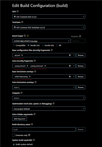

I  tried to test OTA function with smp_svr example.
I want to use the external flash mx25r64 on nrf54l15-dk(v0.9.3) to store update Firmware over BLE.  SDK version 3.2.0 was used.
The driver and dts for mcuboot was configured with "sysbuild\mcuboot.conf", "sysbuild\mcuboot.overlay".
partitions manager was used with "pm_static.yml".
Before mcuboot start, mspi and flash driver was loaded correctly.

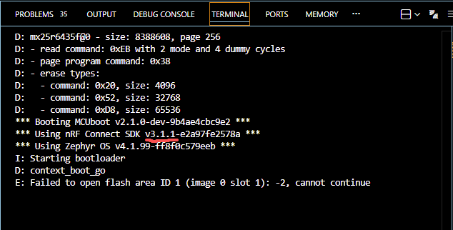

Then mcuboot to read seconed image slot on external flash failed. could you give some advice for this issue?

    Please try adding SB_CONFIG_PM_OVERRIDE_EXTERNAL_DRIVER_CHECK=y to the sysbuild.conf file. This should enable the bootloader to access the secondary slot using the MSPI NOR driver without the -ENOENT error.

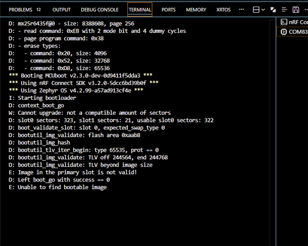

    This configuration has indeed taken the program one step forward, but the image check reports a new "slot sectors" error.
    Are there any other configuration items related to partition?

    Please also add CONFIG_FLASH_MSPI_NOR_LAYOUT_PAGE_SIZE=4096 to your mcuboot and application project configuration to ensure the sector size matches the sector size used in internal memory.

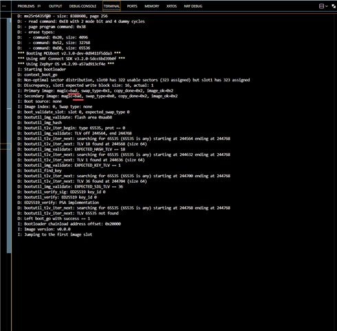

  • Thanks for your help.
    when CONFIG_FLASH_MSPI_NOR_LAYOUT_PAGE_SIZE=4096 was added to mcuboot and app configuration, mcuboot stop at "I: Jumping to the first image slot".
    Does it means image in slot-0 is invalid when image magic is bad checked by mcuboot.
    Is there any other configuration for image need to be set?

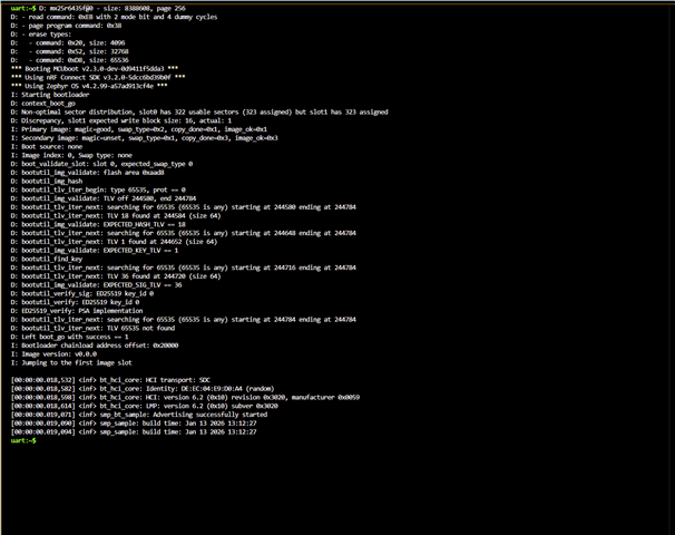

    I was able to reproduce the same here and it turns it was the same problem reported in this thread: nRF54L15 + MCUboot + External flash with SQSPI: VPR problems causing the application code to hang on startup. However, patching the sqspi driver as suggested in that thread did not work for me. Instead I had to modify the bootloader code to reset VPR before branching to the app:
    diff --git a/boot/zephyr/nrf_cleanup.c b/boot/zephyr/nrf_cleanup.c
    index c1e5a178..e7f49289 100644
    --- a/boot/zephyr/nrf_cleanup.c

    @@ -111,6 +116,24 @@ static void nrf_cleanup_clock(void)
    +#if defined(CONFIG_MSPI_NRF_SQSPI)
    +static void nrf_cleanup_sqspi(void)
    +    nrf_vpr_cpurun_set(NRF_VPR, false);
    +    // Reset VPR.
    +    nrf_vpr_debugif_dmcontrol_mask_set(NRF_VPR,
    +                                       (VPR_DEBUGIF_DMCONTROL_NDMRESET_Active
    +                                        << VPR_DEBUGIF_DMCONTROL_NDMRESET_Pos |
    +                                        VPR_DEBUGIF_DMCONTROL_DMACTIVE_Enabled
    +                                        << VPR_DEBUGIF_DMCONTROL_DMACTIVE_Pos));
    +                                       (VPR_DEBUGIF_DMCONTROL_NDMRESET_Inactive
    +                                        VPR_DEBUGIF_DMCONTROL_DMACTIVE_Disabled
    +#endif
     void nrf_cleanup_peripheral(void)
     #if defined(NRF_RTC0)
    @@ -123,6 +146,10 @@ void nrf_cleanup_peripheral(void)
         nrf_cleanup_rtc(NRF_RTC2);
    +    nrf_cleanup_sqspi();
    +#endif
     #if defined(CONFIG_NRF_GRTC_TIMER)
         nrf_cleanup_grtc();
    Could you please try applying the the same change on your end?
