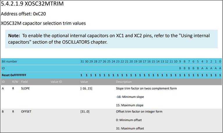

Specifically, I refered to section 4.12.1.1 Using internal capacitors in the nRF5340 datasheet, section 4.12 OSCILLATORS — Oscillator control.

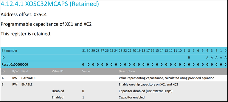

The instructions explain how to read the values ​​of XOSC32MTRIM.SLOPE and XOSC32MTRIM.OFFSET from the registers and input them into the formula below. Then, input the CAPACITANCE value (7.0pF ~ 20.0pF, 0.5pF steps, obtained from devicetree &hfxo's load-capacitance-femtofarad) to obtain CAPVALUE. Finally, write CAPVALUE into the XOSC32MCAPS register at position A. Please correct me if my understanding is incorrect. Thank you.
CAPACITANCE Value

XOSC32MTRIM Register Address
CAPVALUE Equation
XOSC32MCAPS Register Address
Is this method feasible in application code? Or could you provide a method?
