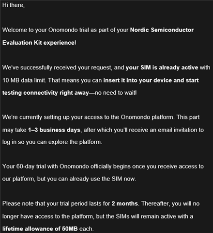

I am currently trying to claim my nRF9151DK on the nrf cloud. I went through the Quick Start steps and activated my SIM card but my device has been stuck in this state for quite some time now:
I received this email after setting up the SIM card so I assume it is activated:

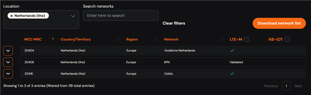

When I look at the serial output of the device I do see a bunch of warnings about registration being rejected. Could this be the issue?

[00:00:11.026,763] <wrn> lte_lc: Registration rejected, EMM cause: 15, Cell ID: 14257275, Tracking area: 258, LTE mode: 7
[00:00:11.686,462] <wrn> lte_lc: Registration rejected, EMM cause: 15, Cell ID: 568589, Tracking area: 31601, LTE mode: 7
[00:00:12.210,754] <wrn> lte_lc: Registration rejected, EMM cause: 15, Cell ID: 25958659, Tracking area: 22711, LTE mode: 7
[00:01:11.307,067] <wrn> lte_lc: Registration rejected, EMM cause: 13, Cell ID: 25958759, Tracking area: 12711, LTE mode: 9
[00:01:16.333,007] <wrn> lte_lc: Registration rejected, EMM cause: 15, Cell ID: 14257395, Tracking area: 1258, LTE mode: 9
