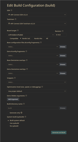

hci_uart will not flash with VS Studio
I have a new nrf9160dk board that I will be using for a BLE customer application. I am using zephyr/samples/bluetooth/hci_uart SDK V3.2.0 to be loaded into the nRF52840 in the DK board. I can build and compile with VS Studio with no problems. When I try to flash it into the nRF52840 (switch SW10 set to nRF52) it fails. see below. I tried to flash it using the programmed which said it was programmed but it did not run or boot the nRF52840. There is a startup message in the code. any help you can give would be greatly appreciated since this is needed for a customer application.
