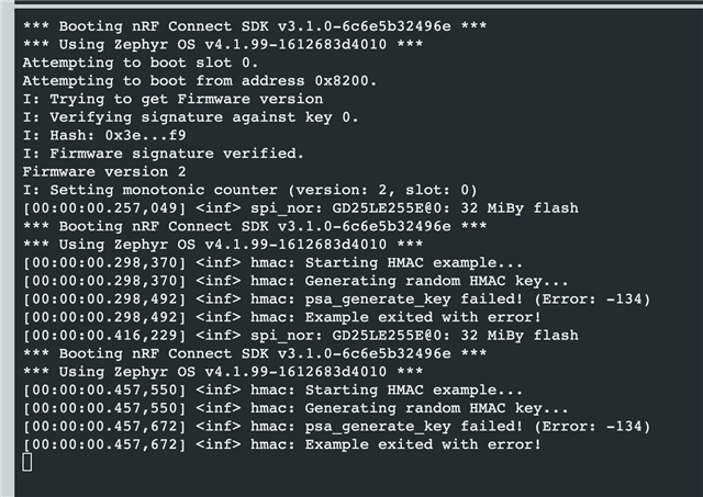

    [00:00:00.258,026] <inf> spi_nor: GD25LE255E@0: 32 MiBy flash
    *** Booting nRF Connect SDK v3.1.0-6c6e5b32496e ***
    *** Using Zephyr OS v4.1.99-1612683d4010 ***
    [00:00:00.299,346] <inf> hmac: Starting HMAC example...
    [00:00:00.299,346] <inf> hmac: Generating random HMAC key...
    [00:00:00.299,468] <inf> hmac: psa_generate_key failed! (Error: -134)
    [00:00:00.299,468] <inf> hmac: Example exited with error!

  • Hi Øyvind,
    Also from me, apologies for the late reply.
    I tried you suggestion and the result is the same.
    The second boot was with NO_DEFINED_LAYOUT.
    Here is the build output:

  • Hi Øyvind,
    west build -p -b thingy91x/nrf9151/ns -- -DSB_CONFIG_THINGY91X_NO_PREDEFINED_LAYOUT=y

    RAM: 10692 B 40 KB 26.10%
    [141/141] Linking C static library secure_fw/libtfm_s_veneers.a
    [19/278] Performing install step for 'tfm'
    -- Install configuration: "MinSizeRel"
    ----- Installing platform NS -----
    [278/278] Linking C executable zephyr/zephyr.elf
    Memory region Used Size Region Size %age Used
    FLASH: 70260 B 992 KB 6.92%
    RAM: 25104 B 203416 B 12.34%
    IDT_LIST: 0 GB 32 KB 0.00%
    Generating files from /Users/andy/nordic/ncs/v3.1.0/nrf/samples/crypto/hmac/build/hmac/zephyr/zephyr.elf for board: thingy91x
    [10/10] Generating ../merged.hex
    nrfenv  12:09  andy  ~/nordic/ncs/v3.1.0/nrf/samples/crypto/hmac  ◈ v3.1.0  west flash --recover
    -- west flash: rebuilding
    [0/5] Performing build step for 'hmac'
    [0/14] Performing build step for 'tfm'
    ninja: no work to do.
    [2/3] Performing install step for 'tfm'
    [3/3] Completed 'tfm'
    [4/5] cd /Users/andy/nordic/ncs/v3.1.0/nrf/samples/crypto/hmac/build/_sysbuild && /opt/homebrew/bin/cmake -E true
    -- west flash: using runner nrfutil
    -- runners.nrfutil: reset after flashing requested
    Using board 000853003346
    -- runners.nrfutil: Recovering and erasing all flash memory.
    -- runners.nrfutil: Flashing file: /Users/andy/nordic/ncs/v3.1.0/nrf/samples/crypto/hmac/build/merged.hex
    -- runners.nrfutil: Connecting to probe
    -- runners.nrfutil: Erasing address ranges touched by firmware
    -- runners.nrfutil: Programming image
    -- runners.nrfutil: Verifying image
    -- runners.nrfutil: Reset
    -- runners.nrfutil: Board(s) with serial number(s) 853003346 flashed successfully.
