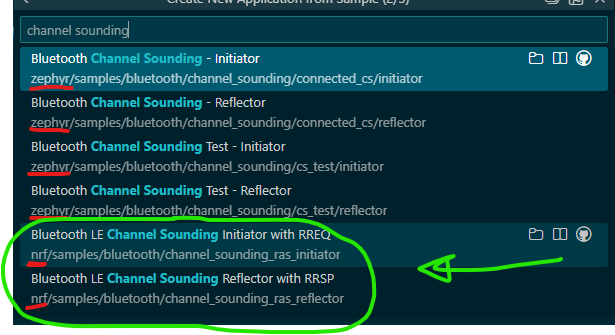

    I am a bit uncertain about some things, like this:
    [10:55:40.517]收←◆W: Mismatch of local and peer step mode 2 != 1
    Did you use the samples from the nRF repo? this and this?

    Booting nRF Connect SDK v3.1.1-e2a97fe2578a
    Using Zephyr OS v4.1.99-ff8f0c579eeb
    I'm currently using this version without any modifications. I directly compiled and downloaded it to the development board through vscode. Now I want to use the development board for verification and then develop and apply it to my own products.
    thank you.
  • I dont think that bootbanner necessarily implies any of the two. Please have a look at what sample you used. Is it from the nRF repo?
  • I updated to the latest sdk3.2.1, but the test results were still not good.
    I used the official latest test demo, and the test results were very unsatisfactory. I don't know if it's a problem with my testing method or something else. I hope to get your help .

  • CS doesn't perform as well as UWB, but I agree that it should do better than this. It can take some time before it settles to a certain range, but I am not getting the impression you've observed this either.
    Whether it was from the zephyr repo or the nRF one is what I am after.
    We provide more support for the nRF one, and that is the one we've made ourselves. Channel sounding is somewhat new as well, so it might be that the zephyr one does perform differently. Though with that said: I wouldn't expect either of the two to perform this bad. You can also check what the default name of the sample is. That should tell me all I need to know.
