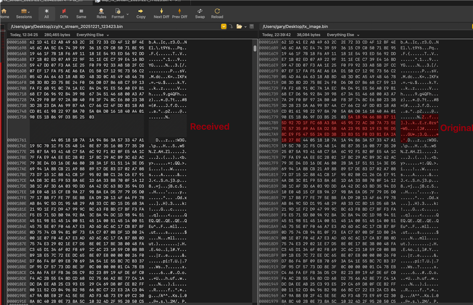

At this time, when I receive the data and compare in the BEYOND COMPARE software, I noticed that from a certain point onward, the received data becomes corrupted, appearing as garbled characters—similar to what happens with UDP. It seems that TCP is not performing handshake or error correction properly.
Subsequently, I introduced a ping-pong buffer mechanism, splitting the image into multiple 4 KB buffers and sending them sequentially. I suspected that excessive data might be causing issues with TCP transmission, and breaking the data into smaller chunks might help resolve the problem.

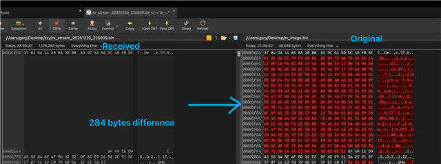

The issue of data loss still occurs, although fortunately, it only happens once somewhere in the middle of the transmission—the remaining data can still be matched to the original image. However, if the ping-pong buffer is not used, all subsequent data from a certain point onward becomes completely inconsistent with the original image.
Afterward, I modified the maximum number of bytes that can be sent in each call to `camsend`, reducing it from 1024 to 66. I observed that the frequency of data misalignment increased, but the number of misaligned bytes per instance decreased.
I can’t think of any other factors that might be causing this issue. Why would data loss occur when using the TCP protocol?

I’ve attached my code and kindly request your assistance. Thank you so much!
6232.TCPsample.zip
  • Hi Zhou,
    Thanks for reaching out, we are currently understaffed due to Christmas holidays. Answers may take longer.
    I am starting to look into this, we'll come back to you when I have an update.
    Benjamin
    ChatGPT ask me to change cam send
    from
    void cam_send(const void *buf, size_t len){
    		#if defined(CONFIG_SAMPLE_SCOKET_TCP)
    			if (send(tcp_server_socket, buf, len, 0) == -1) {
    				perror("Sending failed");
    				close(tcp_server_socket);
    				FATAL_ERROR();
    				return;
    		#else
    			sendto(udp_socket, buf, len, 0, (struct sockaddr *)&pc_addr,  sizeof(pc_addr));
    to
            size_t total_sent = 0;
            int retry_count = 0;
            const int MAX_RETRIES = 3;
            while (total_sent < len && retry_count < MAX_RETRIES) {
                ssize_t sent = send(tcp_server_socket,
                                   (uint8_t*)buf + total_sent,
                                   len - total_sent, 0);
                if (sent == -1) {
                    if (errno == EAGAIN || errno == EWOULDBLOCK) {
                        // 缓冲区满,稍后重试
                        k_sleep(K_MSEC(10));
                        retry_count++;
                        continue;
                    // 其他错误,连接断开
                    return;
                total_sent += sent;
                retry_count = 0; // 成功发送后重置重试计数
            if (total_sent < len) {
                LOG_ERR("Failed to send all data after retries");
        #else
    The the data loss will be sloved. But I am not so sure about why this will work.
  • This reply was deleted.
    I had a look at your code. The reason is that the send function may send fewer bytes than requested. This is normal behavior when working with TCP. TCP is a byte stream protocol, so partial sends are expected. It is correct to repeatedly call send until all data has been sent, as you’ve done in the second function.
    Benjamin
