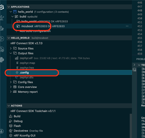

    The CONFIG_KERNEL symbol is not defined by the SDK, so unless you have defined it, I would have expected a build error. Please check the generated .config for your mcuboot build to confirm whether PM_OVERRIDE_EXTERNAL_DRIVER_CHECK and your other configuration overlays are applied or not.
