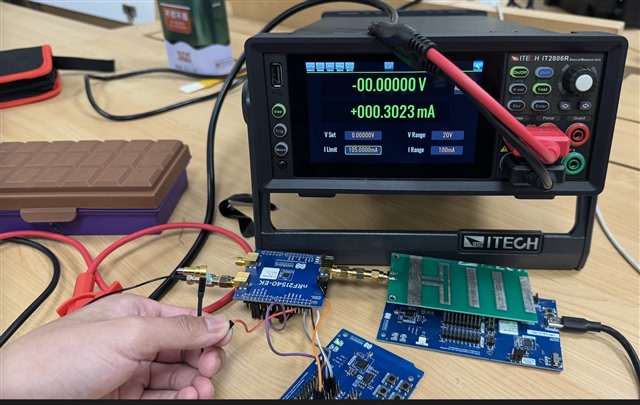

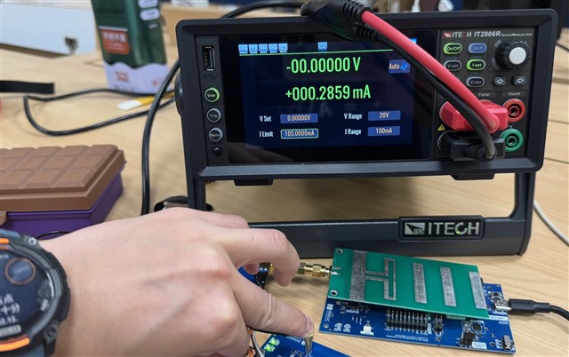

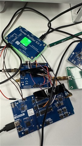

Why the power consumption is lower when using nrf21540 (20 dBm) lower than no FEM (8dBm)
Hello, I observed that under low-throughput conditions (2 kbps), the power consumption of the nRF21540 combined with the 54L15 (at 20 dBm) is actually lower than that of using the 54L15 alone (at 8 dBm). When using the front-end module (FEM), my project configuration is

The measured current consumption with and without FEM is as follows.
Could you please let me know whether my measurements are accurate? And do you have any explanation for this observation?

    I found that with FEM the average current is 7.04 mA, max is 20.91mA
    withFEM1300.ppk2
    The average of without FEM is 17.08 mA, maxis 29.31 mA.
    noFEM1300.ppk2
    My peripheral and central code is:
    central_uart-main.zip
    peripheral_uart-master.zip
    I am using PPK to monitor the current of total nRF54L15 DK+FEM like this, the FEM is connected to VDDIO and GND.
    Could you plz help me?

  • The PPK2 in your setup will only measure the nRF54L15 current, not anything else as far as I can see in the picture. Draw up a diagram of your connections and we can double check. That includes where exactly on the DK you tap the power to the FEM
    With just the picture it's easy to make wrong assumptions so could lead to longer time for a correct answer.

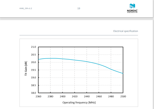

    With the FEM, the nRF54L15 output power "should" be 0dBm but can be anything less than 2dBm or so, if you request less than 20dBm then it will be lower.
