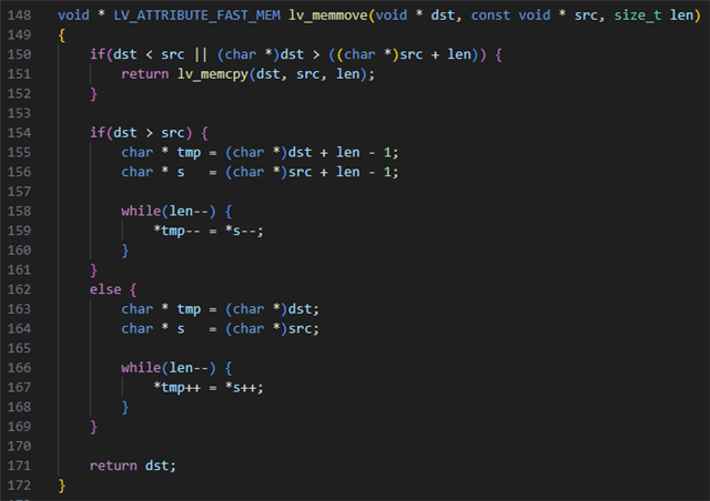

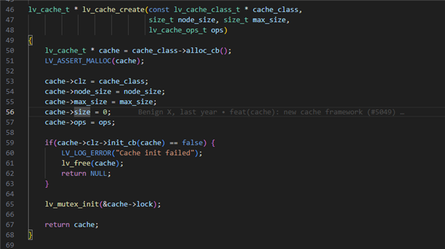

Hi
I try to start with ST7789 display on nRF54L15 and there are bus fault after add LVGL library. The project is building correctly, but stop just after leave bootloader. When I cut off LVGL lib, program start and LED blinks. I used NCS3.1.1 and my own board. I changed between SPI00 and SPI30, but the same situation. Is there any problem with mipi and spi in nRF54l15 implementation?
LOG:
00> *** Booting MCUboot v2.1.0-dev-ae1ee57f3906 ***
00> *** Using nRF Connect SDK v3.0.2-89ba1294ac9b ***
00> *** Using Zephyr OS v4.0.99-f791c49f492c ***
00> I: Starting bootloader
00> I: Primary image: magic=unset, swap_type=0x1, copy_done=0x3, image_ok=0x3
00> I: Secondary image: magic=unset, swap_type=0x1, copy_done=0x3, image_ok=0x3
00> I: Boot source: none
00> I: Image index: 0, Swap type: none
00> I: Bootloader chainload address offset: 0x10000
00> I: Image version: v0.1.1
00> I: Jumping to the first image slot
00> [00:00:00.246,500] <err> os: ***** BUS FAULT *****
00> [00:00:00.246,510] <err> os:   Precise data bus error
00> [00:00:00.246,514] <err> os:   BFAR Address: 0xc
00> [00:00:00.246,525] <err> os: r0/a1:  0x00000000  r1/a2:  0x00000009  r2/a3:  0x00000000
00> [00:00:00.246,532] <err> os: r3/a4:  0x00000000 r12/ip:  0x00000000 r14/lr:  0x000497ef
00> [00:00:00.246,536] <err> os:  xpsr:  0x69000000
00> [00:00:00.246,540] <err> os: Faulting instruction address (r15/pc): 0x0005c3b2
00> [00:00:00.246,573] <err> os: Current thread: 0x200044b8 (unknown)
