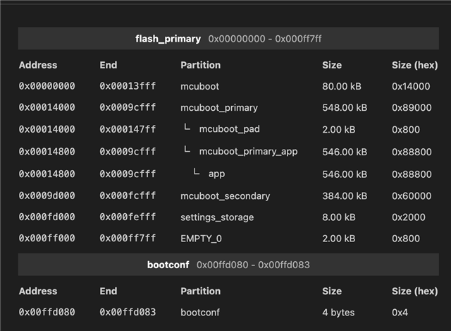

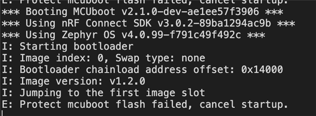

I'm working with NRF54L10 module. I needed more mcuboot space so in pm_static.yml I allocated it 80kb. Before this FPROTECT was working but after I allocated 80kb, now FPROTECT is giving me this error. I also tried allocating 96kb but that didnt work either. Am I able to allocate 80kb and have FPROTECT work? Is FPROTECT only available for two 32kb regions?
