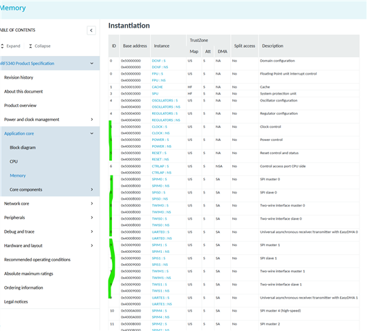

    Also regarding the required number of peripherals (2*UART, 3*I2C, 3*SPI) , please note that the total Available Instances on application core is:
    *Up to 4x UART
    *Up to 4x I2C (TWIM)
    *Up to 5x SPI (4 standard sharing IDs + 1 dedicated high-speed SPIM4)
    But the important point is that not all of the instances can be used simultaneously as they are using shared ID (and base address in memory). Since there are only 4 shared ID slots (ID 0, 1, 2, and 3) plus one dedicated high-speed SPI slot (SPIM4), the application core generally only supports a maximum of 5 serial instances simultaneously.
    So if you are planning to use them simultaneously it is not possible all of them at once, one solution would be to use several external devices on same communication bus for example for SPI or I2C and mitigate the limitation.
    Memory:
    another similar issue:
    (+) How many peripheral instance i can use in nRF5340? - Nordic Q&A - Nordic DevZone - Nordic DevZone
