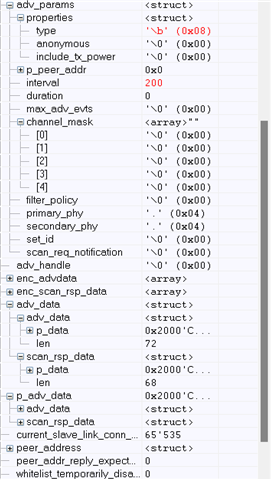

 I am using the nrf52833 with 17.1 SDK and s140_nrf52_7.2.0_softdevice,i want to scan a scannable extend adv packets,
This is what i get in the BLE_GAP_EVT_ADV_REPORT :
p_adv_report->type.scan_response:1
p_adv_report->type.extended_pdu:1
p_adv_report->type.connectable:0
p_adv_report->type.scannable:1
However, the adv data I obtained is not the broadcaster's scan rsp data, but rather the adv data.  The scan response data I set is different from the adv data.
The broadcaster received a scan request from the scanner
I cannot obtain an advertisement with p_adv_report->type.scan_response = 0.
Are there any additional settings I need to configure on the scanning side?
