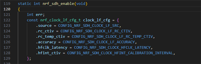

In the bare metal SDK this is configured through config options, see \nrf-bm\subsys\softdevice_handler\nrf_sdh.c which config options:
Then check the allowed various options in \nrf-bm\subsys\softdevice_handler\kconfig
