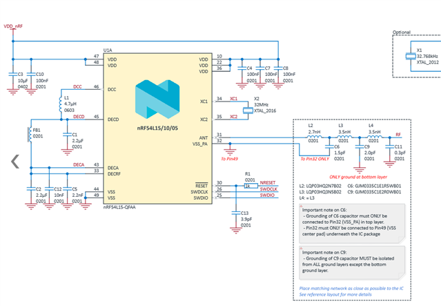

I have designed a embedded system around the nrf54L10 for a project but I have gotten stuck on the RF part.
I would like to use a UfL connector to connect a good antenna to the MCU but how to design and calculate the values of the pi filter and rf section are unknown to me if you could provide something like a application note or so documentation on that regard it will be very helpful.
